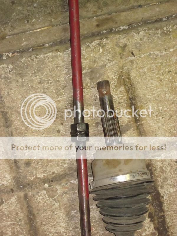

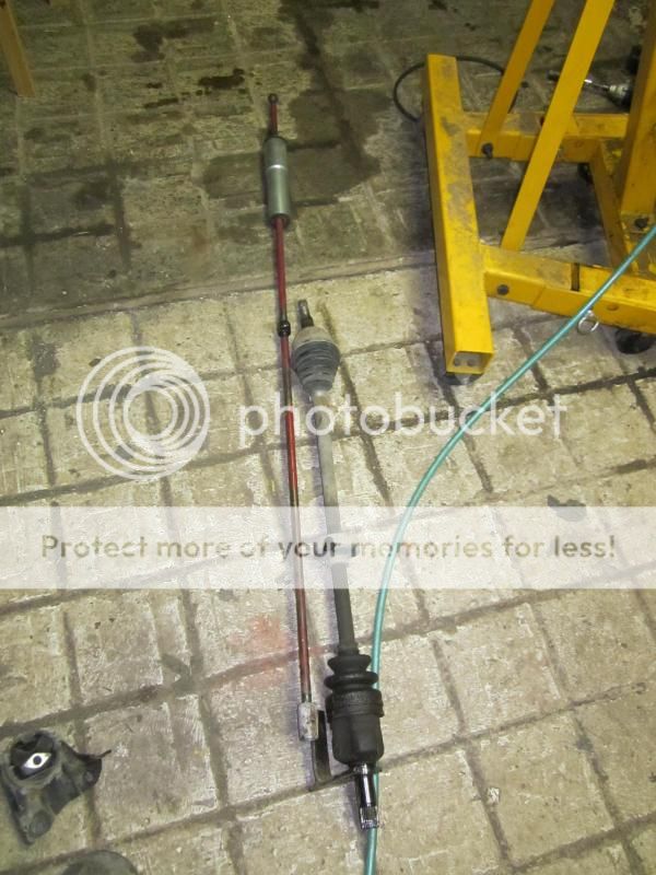

So back to the drawing board. My home made slide hammer that I had made from scrap awhile ago
alwaysFlOoReD's Neon
Fine thread 9/16"[or 5/8"...can't remember] x 24tpi
It happens that my other factory puller ends fit :icon_bounceblue:
So now using the slide hammer with a new attachment I can get both sides
Extended for pass. side
