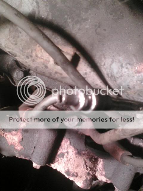

A blurry pic of the line where it fits into the master. I carefully cleaned up the rust with a wire wheel and then replaced the o-ring.
alwaysFlOoReD's first b-II

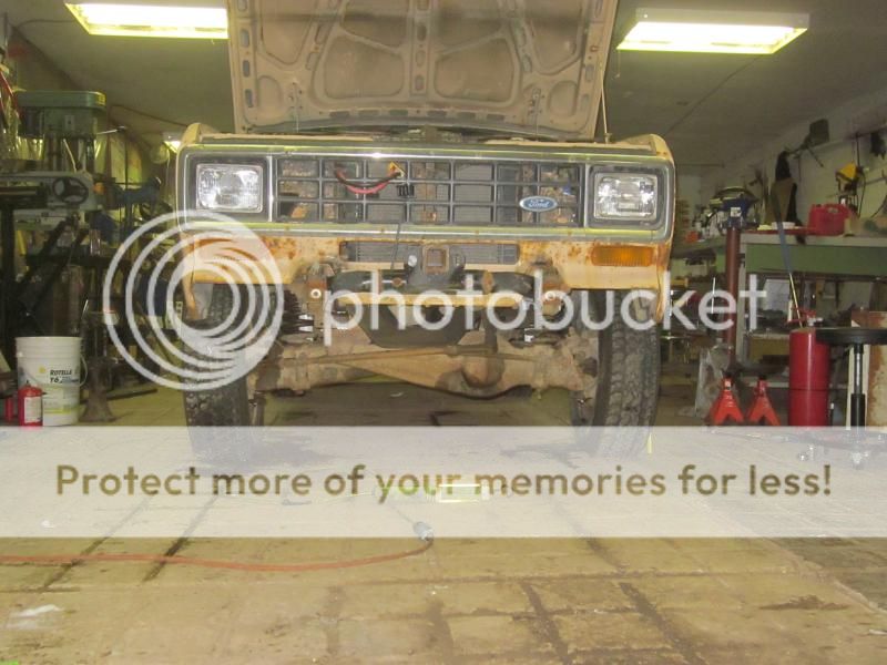

It's been a while since I've done anything to this. I built a mount to adapt a three point hitch snow plow to the front 2" receiver on the B-II a couple of years ago and have been meaning to upgrade the front springs since then....I finally got around to it.

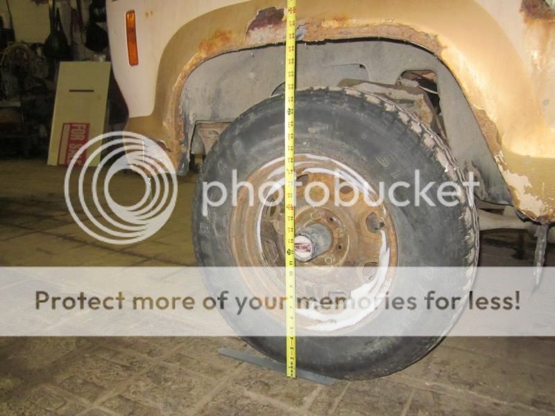

Reference height pics, 12.5" at hub, 29.5" at fender lip

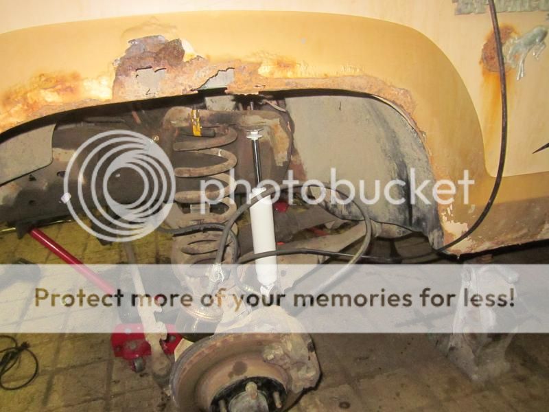

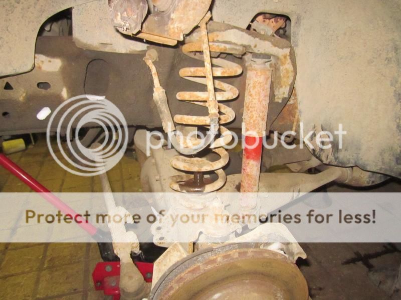

Just before I started on the spring;

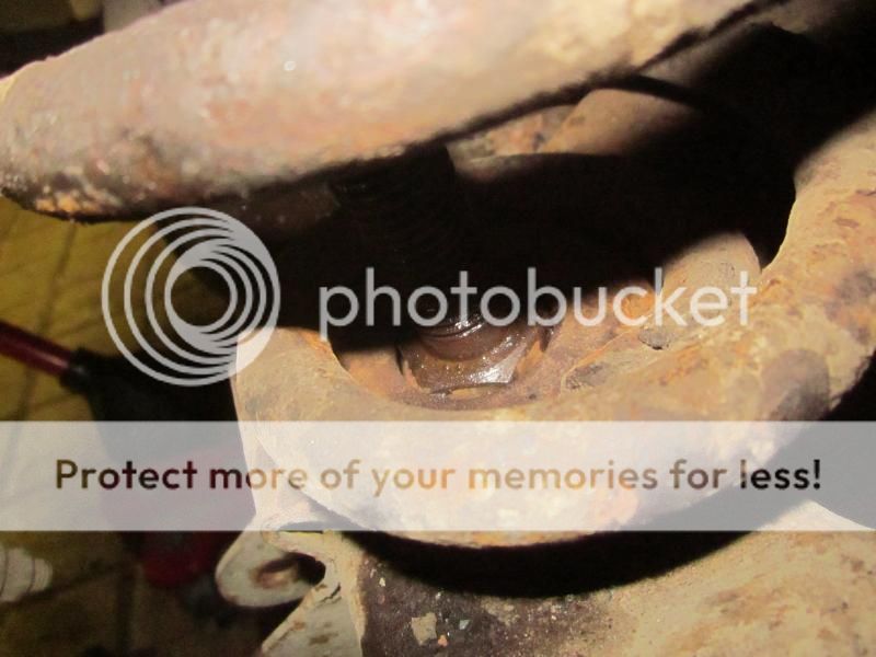

The shock is a pain in the ass, I would have designed a hex into the top of the shock body to hold it from turning while undoing the top nut.

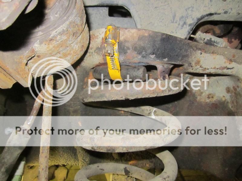

how I tied the top;

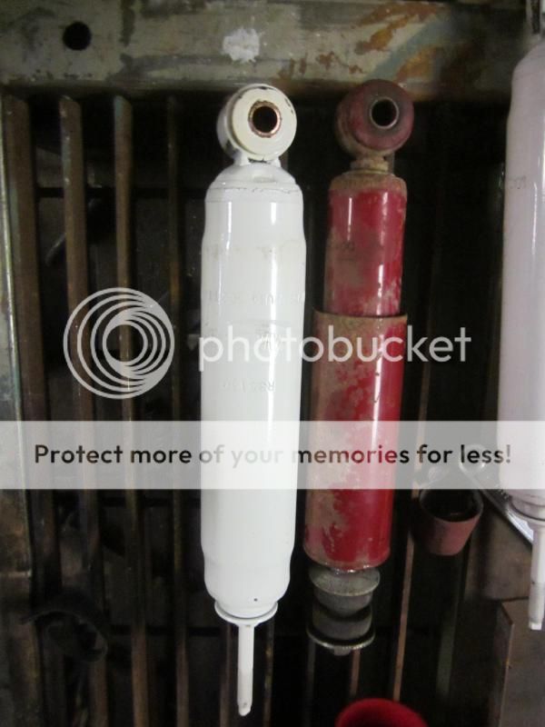

pics comparing stock shock on right with rancho shock on left, the rancho I picked up at a yard sale years ago. It is for a 3" lift durango or something.

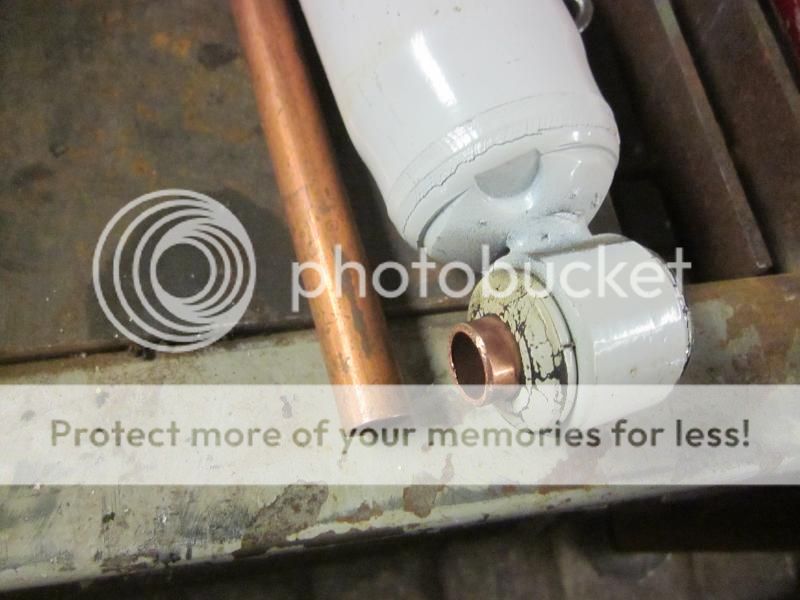

I had to make a bushing. I used some copper water pipe.

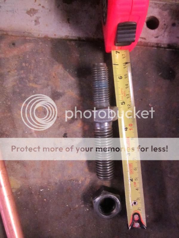

Another reference pic for a d-28 beam spring mount bolt;

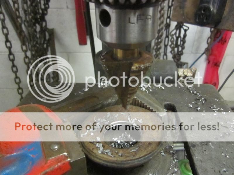

My set up for drilling out the washer to fit over the bolt. The washer is from a f-150 spring mount bolt;

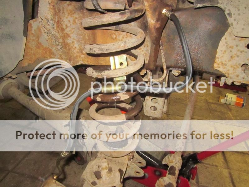

the new longer brake flex line, the same as in the tech section, Wagner bh120541 and bh120542, installed but before removing the metal bracket;
here you can see protrusions that have to be filed off in order to fit into the stock bucket bracket;

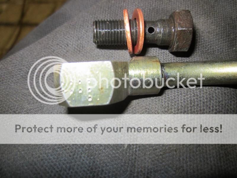

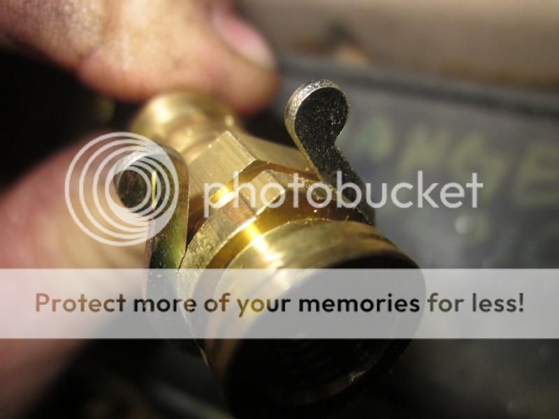

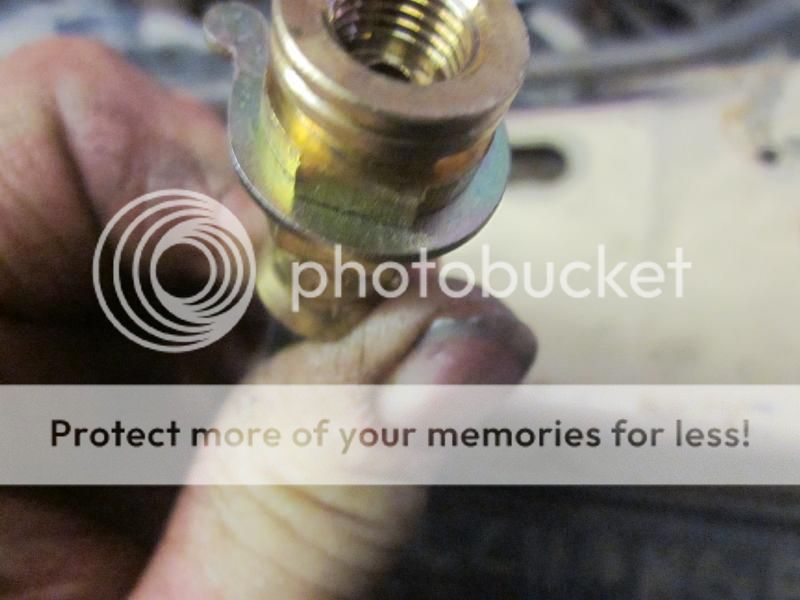

This is why there is a right and left side. I installed new copper washer but didn't pay attention to the end close enough. The flat portion is offset from the round part and will leak if installed wrong way. I caught the screw-up before I added fluid.;
