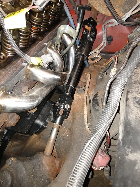

1984-1994 jeep cherokee steering shaft has ujoints on both ends and fits the steering column and gearbox. Only caveat is that the telescoping inner section needs to be cut down because the whole assembly is too long. It's pretty self explanatory once you've got it in your hands. This is what I'm using on my v8 swap, because the rag joints were too close to the header. I paid about $50 on ebay
https://www.ebay.com/itm/143742461786

Aerostars were my go to...but Jeeps and gm are what I tend to rob now. Cut to fit.
