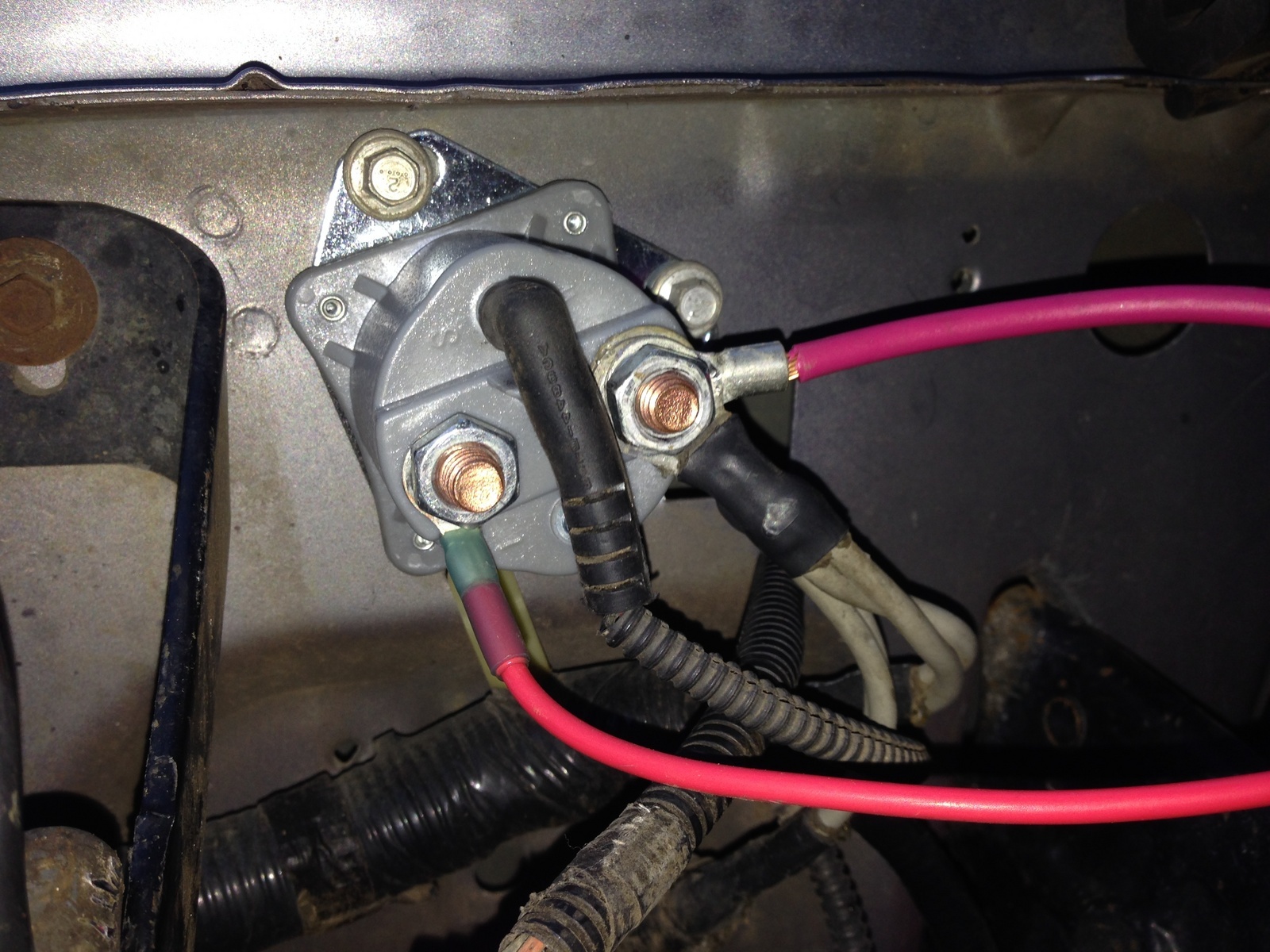

As for bumping the starter, find this thing:
and touch a screw driver to the big posts. It will be near the battery.

As for bumping the starter, find this thing: and touch a screw driver to the big posts. It will be near the battery.
