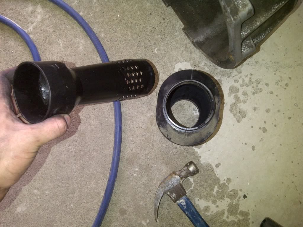

Just took the big plastic thing out, then used a flat screwdriver and hammer to tap the baffle out, was pretty easy. This is what it looks like and beside one that isnt removed.

I see. I'll have to try it sometime. Thanks man! From the picture it looks like it is smooth inside the muffler. Is it just straight inside the casing? That would be a great bonus because I was concerned that it would not be.
I don't understand what you mean by straight inside the casing, but it isnt hard at all to remove you remove the two clamps on it, get it out and remove it, it isnt glued or anything if that was your question, takes about 5 minutes.
