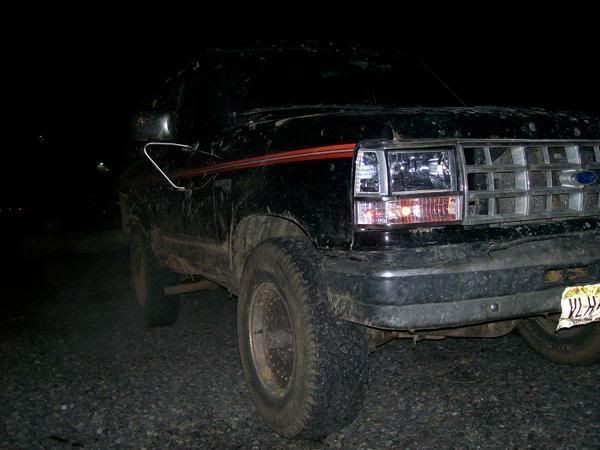

EBAY $106 Shipped:icon_thumby:
Also I had those clear multi-LED bulbs that lit up orange in them looks awesome
Search EBAY for 91-94 Explorer headlights
