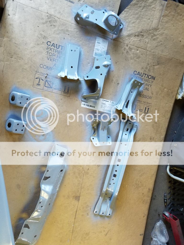

All the brackets and the passenger's frame rail are primed and painted on one side. If the paint is dry enough to handle tomorrow morning I might get to painting the other sides, but I work at least the next 4 days, so it might be a while until I get back to this.

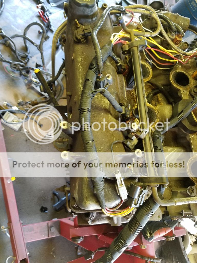

Basically what I did here is I took the SOHC injector harness apart, cut out the injector plugs, got the crank sensor plug and pigtail out, and so on. Then I wired all the injectors together on both sides to make it batch fire. Then I went back to an OHV injector harness I had and opened it up. Then I salvaged the sections for the coil and the O2 sensors from it and put them in the one I am building. Then I started putting in sections of convolute tube and taping it all put with Coroplast. I am going to route the wires from the driver's side across the front of the engine behind the thermostat housing, and run it all out through the little section between the housing and the passenger side head. When I am done this will be plug and play to a batch-fire EEC-IV harness.

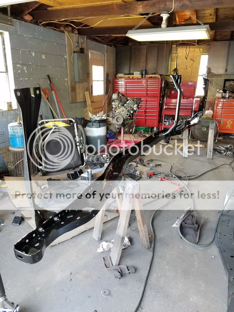

Picture time, picture time, won't you see some pictures of mine.
Its a frame, mostlyish.
