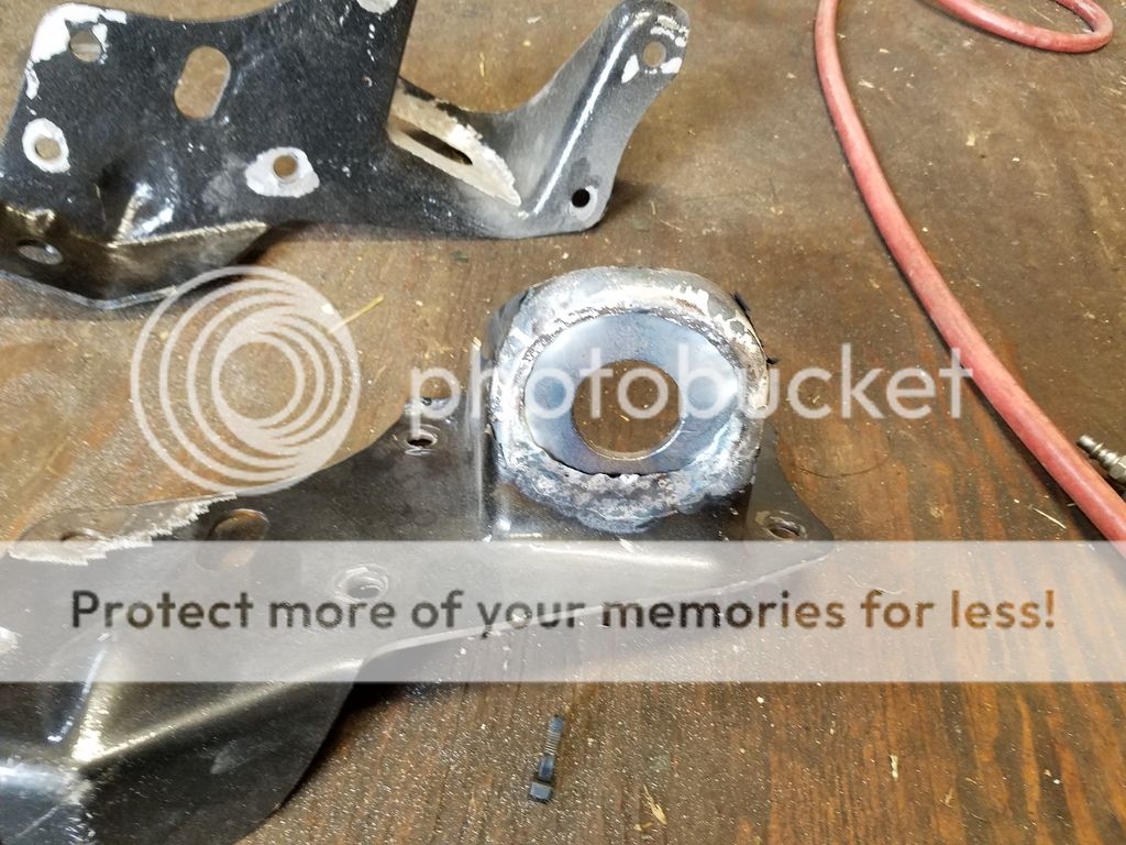

Took some body mount brackets to get a little :icon_welder::icon_welder: tonight.
I only took before(ish) pics of this one, but the other side looked pretty much the same.

I'm not sure why they are called "fender" washers, they don't look like fenders at all, but they sure work well for body brackets.
I don't know why they're called fender washers either. I must've put a dozen in my Ranger and the fenders are still dirty as hell.
