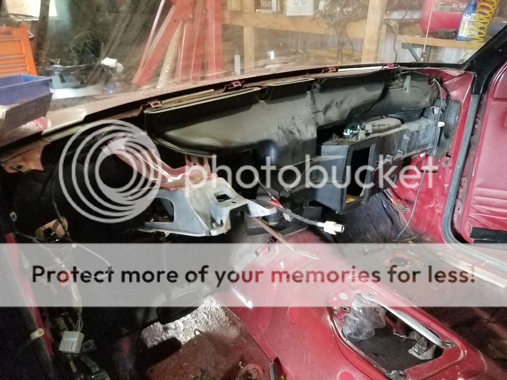

Dash out:
adsm08's Ranger build up
Took 30 minutes, by myself, used power tools on like 3 bolts, and I was doing other stuff in that time. This is how God intended for cars to be put together.

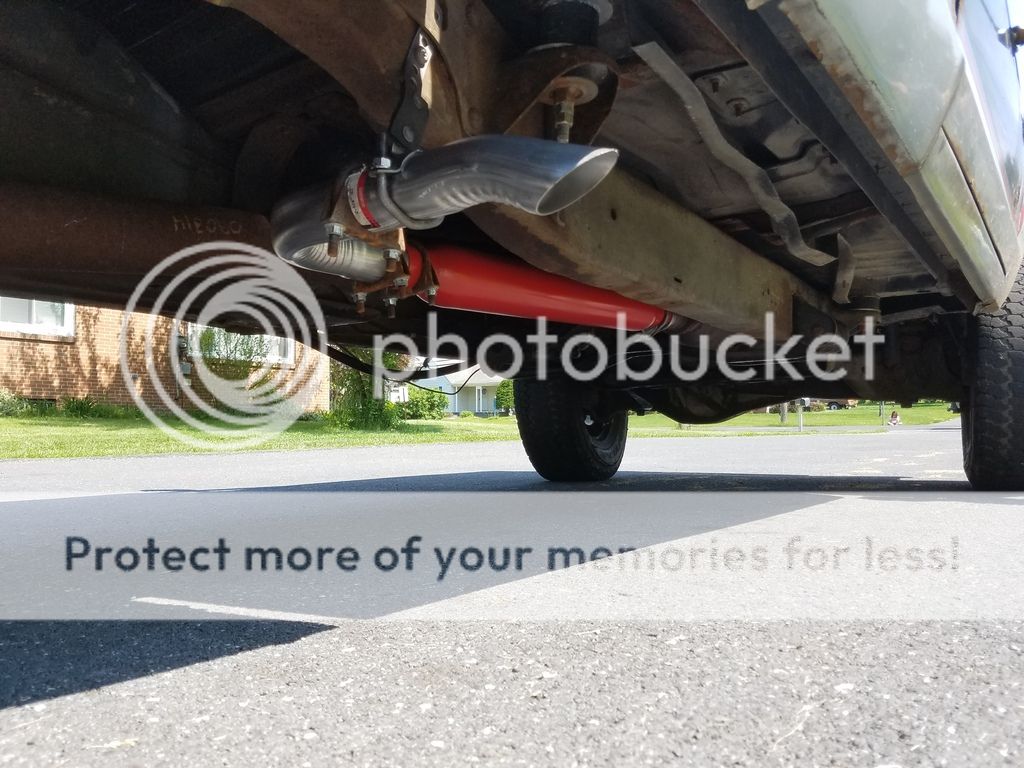

New exhasut:
The safety inspector failed my because it didn't sound cool enough, so my glass pack got moved from the want to the need column.
Now back to our regularly scheduled programming.

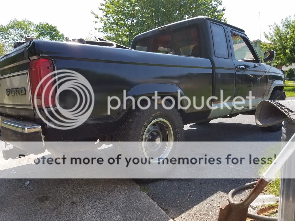

Paint:
Somehow these guys got missed in the photoshoot yesterday:
I have a few runs on the driver's side. I am going to try to level them with these 3200 grit sanding blocks we just started carrying at the store. Other than that and some texture from the sanding it turned out really nice.

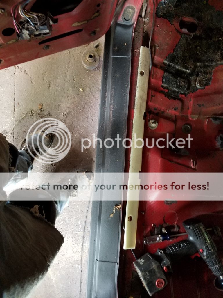

Floors rust wasn't as bad as I thought:

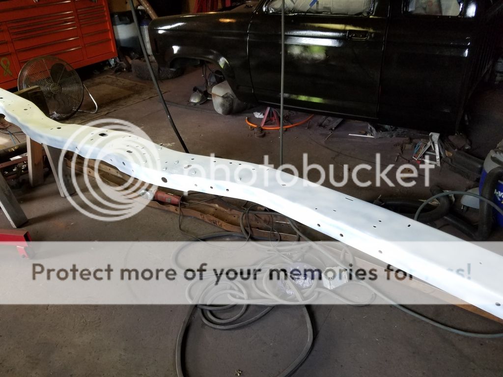

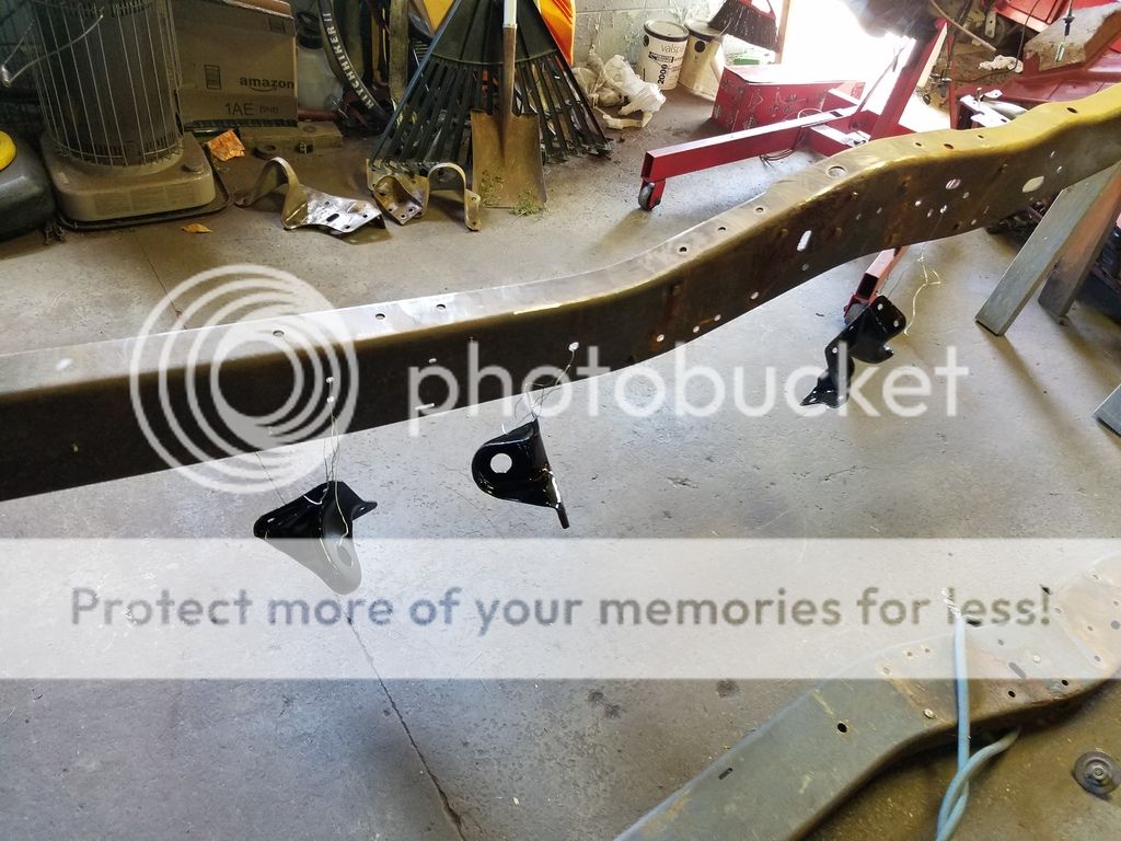

Clean frame rail:
It will be at least a few weeks until I am ready to paint this, so I did it over in a light coat of Valspar rust control primer. It isn't a rust converter, but should lock down any spots I missed when cleaning, and will keep anything new off the metal. Also I should be able to just scuff-sand it and lay my other paint/primer right over it without cleaning again.

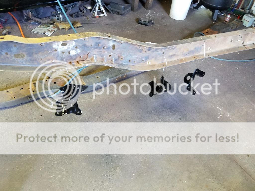

I got the rest of the frame cleaned, I have to wire wheel the last two cross members tomorrow after I do some work for a friend. Once that is done I am going to break out the primer and spray gun and get to it. Frame should be black by tomorrow at dinner.
