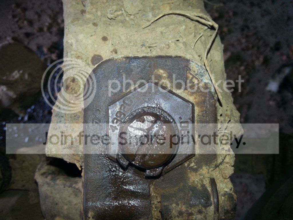

Can any one tell if this is an adjustable bushing? I can't get it out and I don't have a big enough tool to turn it.
It should be a offset bushing which would make it adjustable in the fact that camber and caster are changed at the same time not individually.
its a fixed adjustable bushing. You can only spin it 180 degrees.
For example if its a +2 degree bushing you have +2 degrees positive camber, and you can only spin it 180 degrees to achive -2 degrees camber. Those fixed adjustable bushings only have two setting a positive and negative fixed setting. Spin it any other amount that does not line up with either of the settings and youll have a real funky alignment.
Alright. I just finished shimming my springs to get rid of the camber I was having. But wasn't sure if I needed to buy new bushings for the alignment down the road. And if I did I was just going to stack a lot of washers until I get the 132x coils.
get yourself a set of the moog 0-4 degree fully adjustable two piece bushings. 4+ all the way to -4 and everything in between. Easiest way to get the truck back into alignment instead of shimming and fooling around with spacers. Youll need them once you get the 132x springs.
