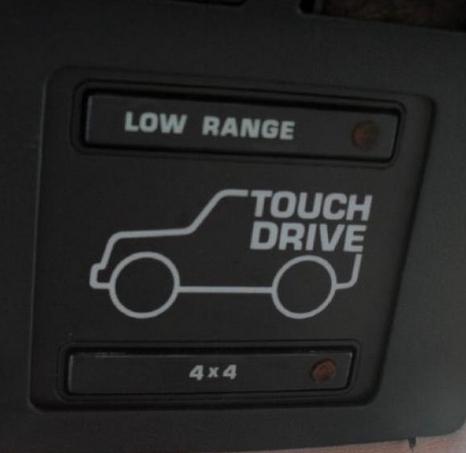

I also have a problem with the low range selector. When I push on low range, the 4x4 is also put, before it did not. It's probably the circuit board but I can not find it anywhere (rockauto etc ..) Would you have the number motorchraft? .And do you know the A4LD box well?
The 4x4 light is supposed to come on when you are in low range, both lights are supposed to be illuminated in low range. Nothing wrong with the system.
