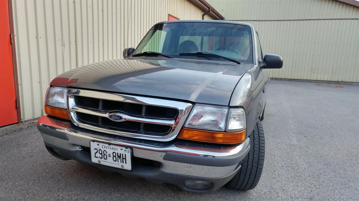

Mine doesn't have any fog light holes in the bumper at all. I don't know if that's because it's a SPORT model, or what. Also mine is an XLT, and it doesn't have the holes. My front bumper looks nothing like the one that Dirtman posted.
No it won't, the bumper which you & I have on our model year truck is unique to 98-2000. The foglights are hung under the bumper surrounded by the valance.
I like that. Honestly, can't recall ever seeing one that looks quite like that one does. Probably going to be difficult to find one.
