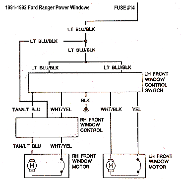

I have a 96 with manual windows. I’m considering adding factory power windows. I have found a donor truck. So my question is, do I need the GEM from the donor or can I add the wires to my GEM?
Here are the different listed GEM modules from the junkyard. I don't see power windows so they might all support that.

Here are some diagrams. Look way down the page for your year. Looks like there is only two connections for the GEM
