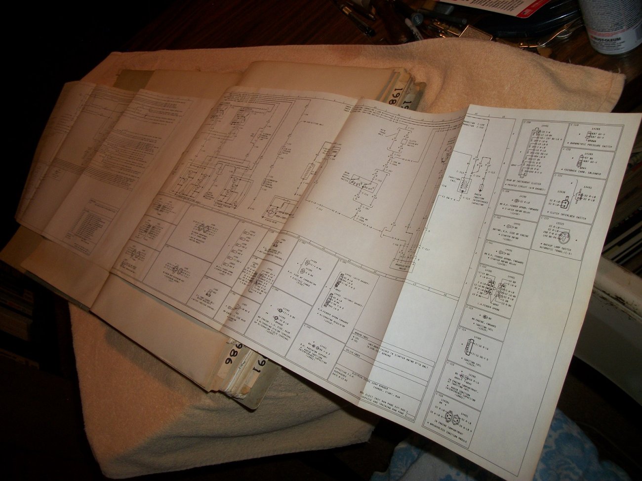

Acquiring literature for my '84 Bronco II.
The truth be told, I am acutely aware that I would be doing a great service to the old gal by Durasparking her. I mainly want to get her up and running and driving to assess what else may be more important first, such as issues with suspension, braking, handling, such and so on. Duraspark and upgrading the starter are up there.
Even if I wouldn't need the manual as much after I did all that, there is a possibility I may one day possess another BII. I have a close friend who really wants one badly.
And if the blue book isn't too much work, maybe I'll find a way to scan it and upload, if that's even allowed. I don't see why a rare, out-of-print book that is so useful should be unobtainium for those who need it.
