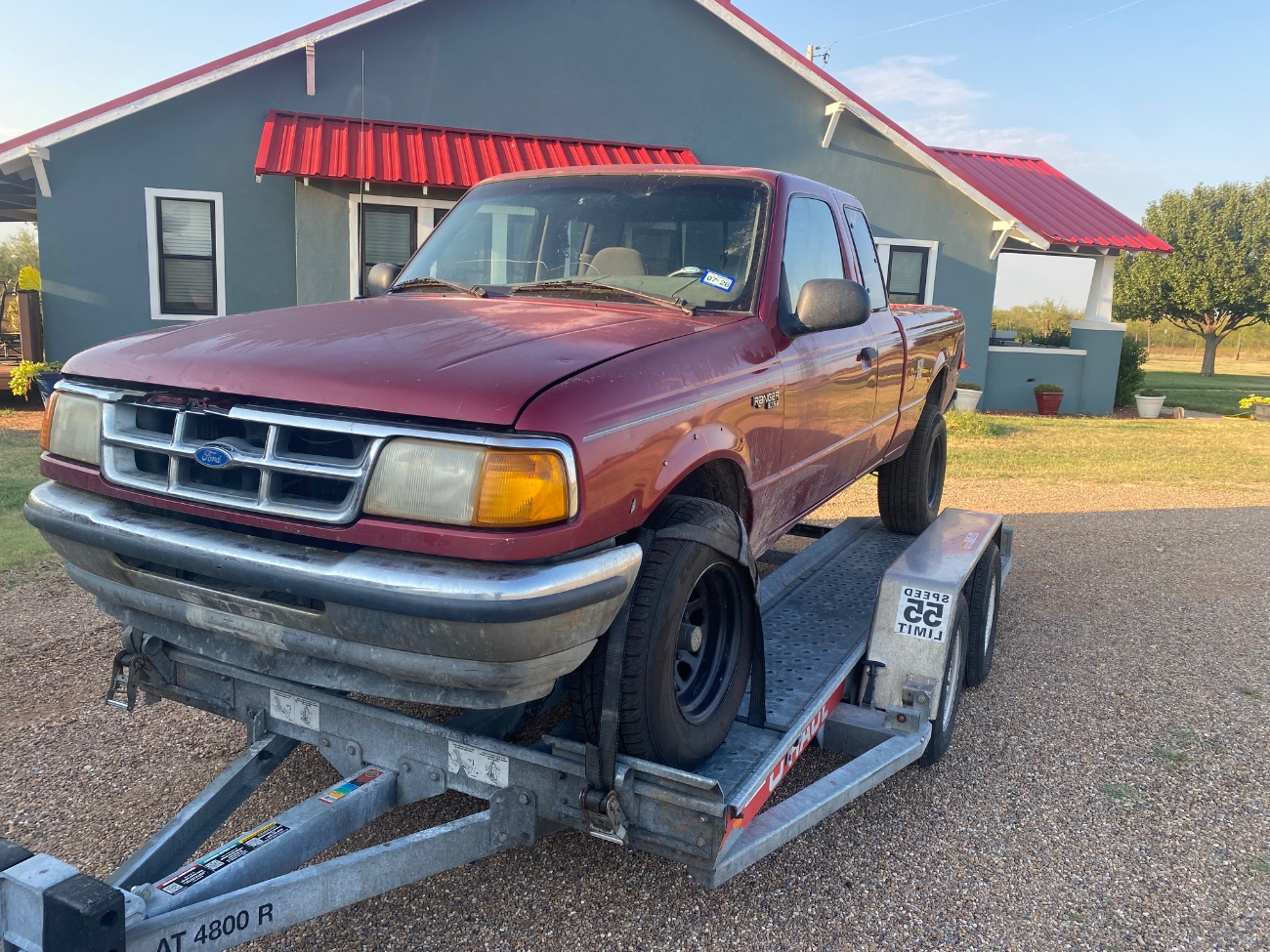

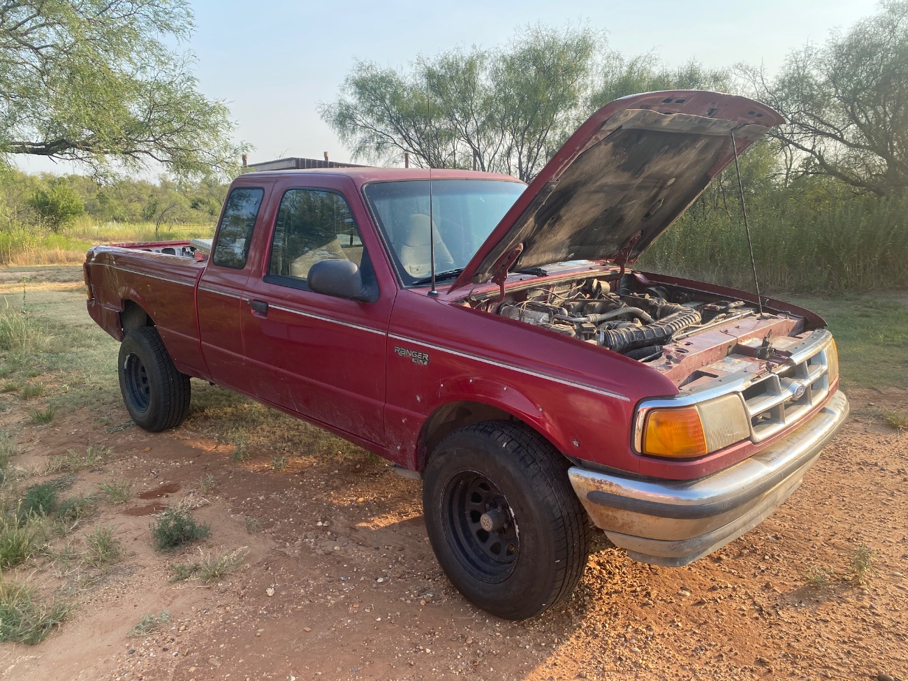

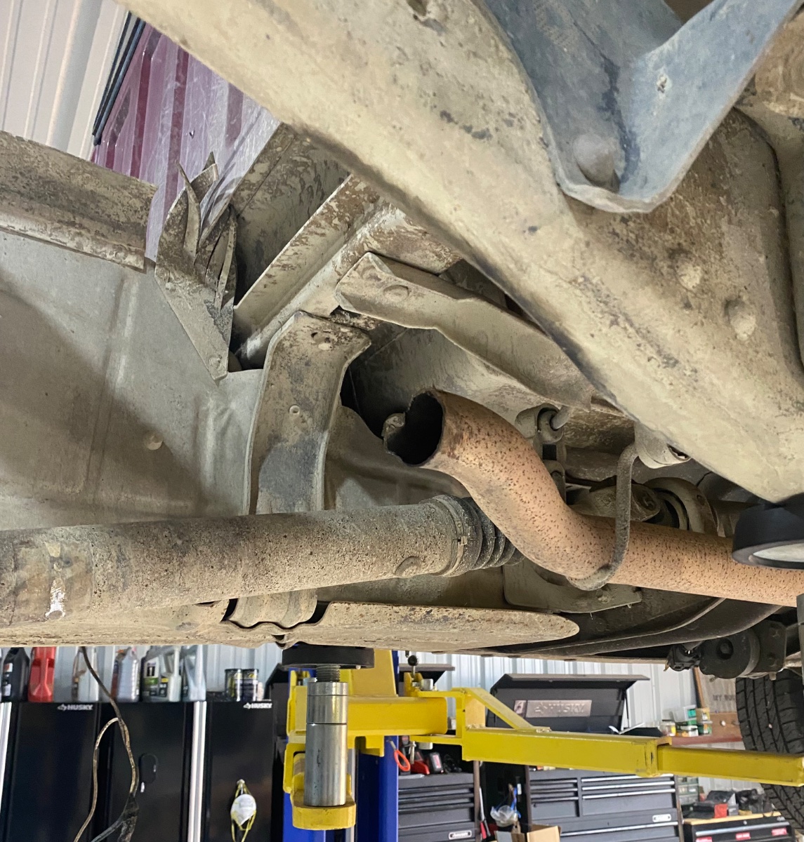

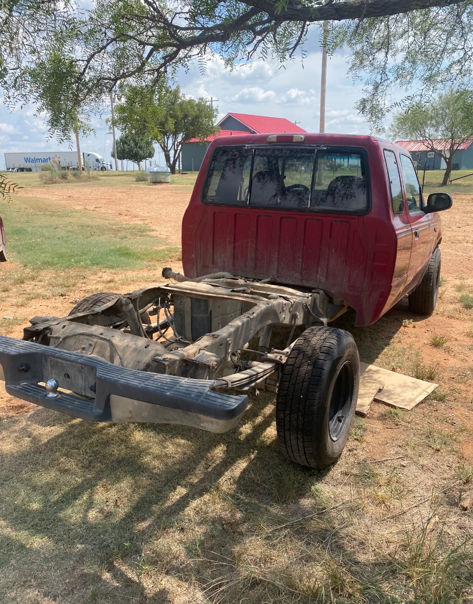

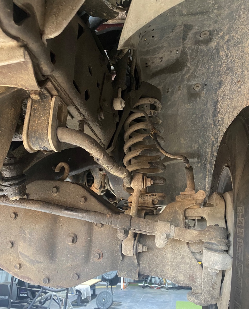

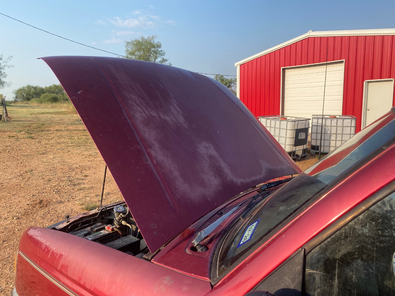

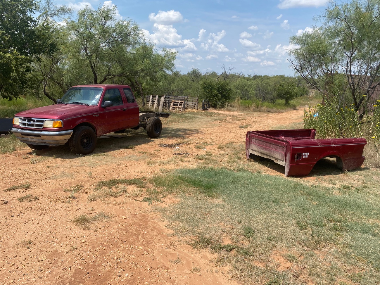

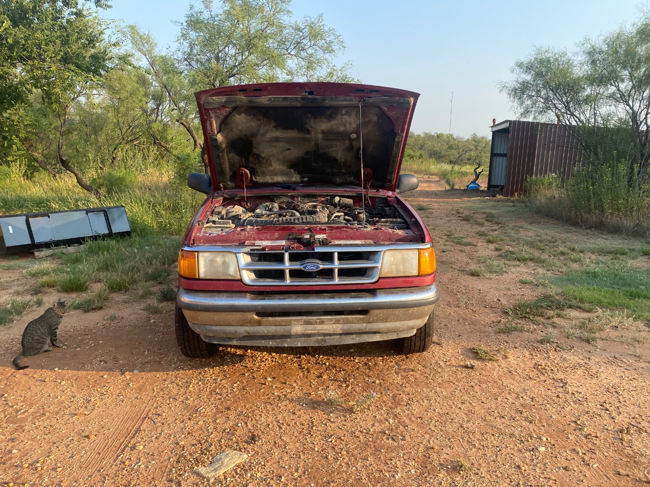

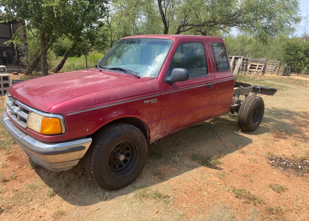

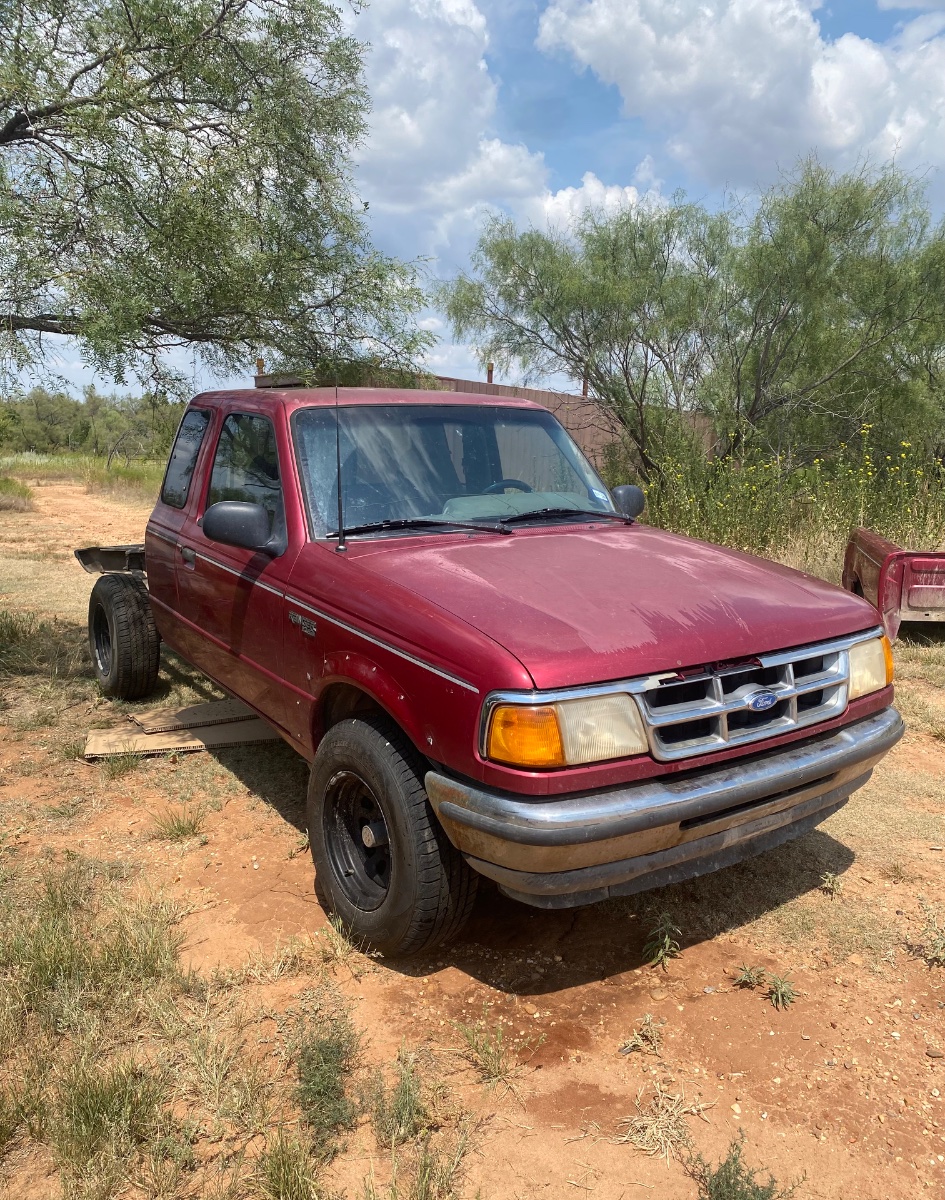

Yesterday I picked up a 1994 4x4 Ranger with AT and the 4.0 engine for $700. The trans is shot, but the engine runs and will stay running.
This is going to be a long running project thread where I post progress. The first order of business is swapping the auto transmission for a manual so I can move this thing in and out of the shop easily. I have to start gathering parts for that.

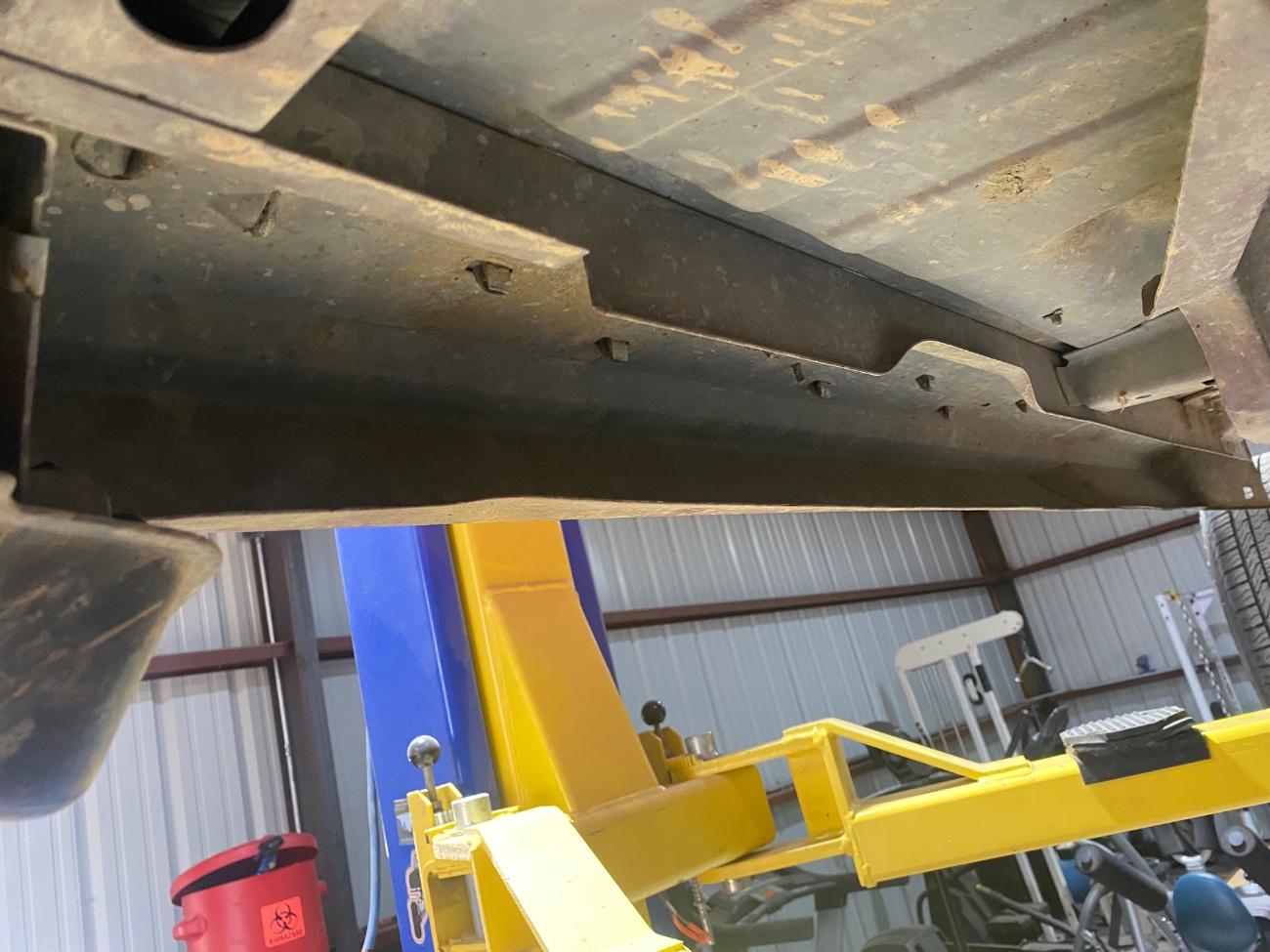

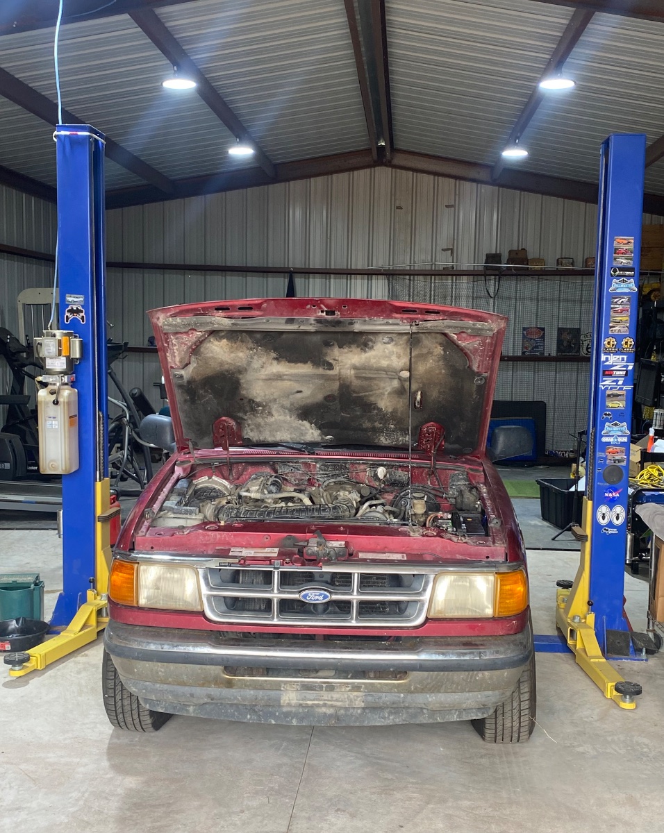

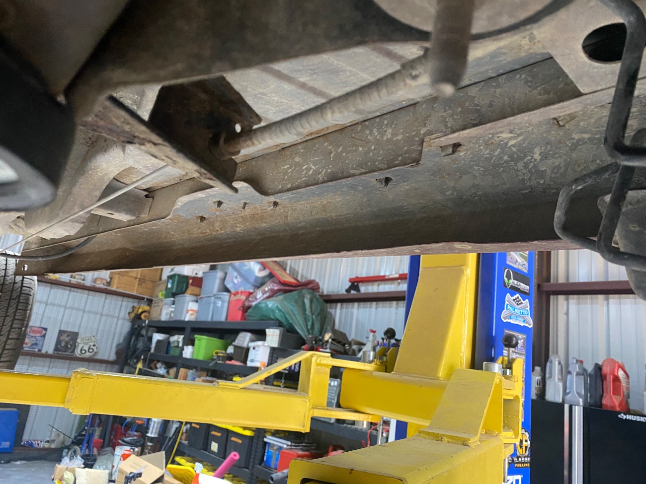

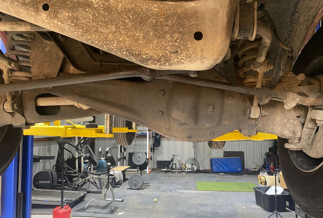

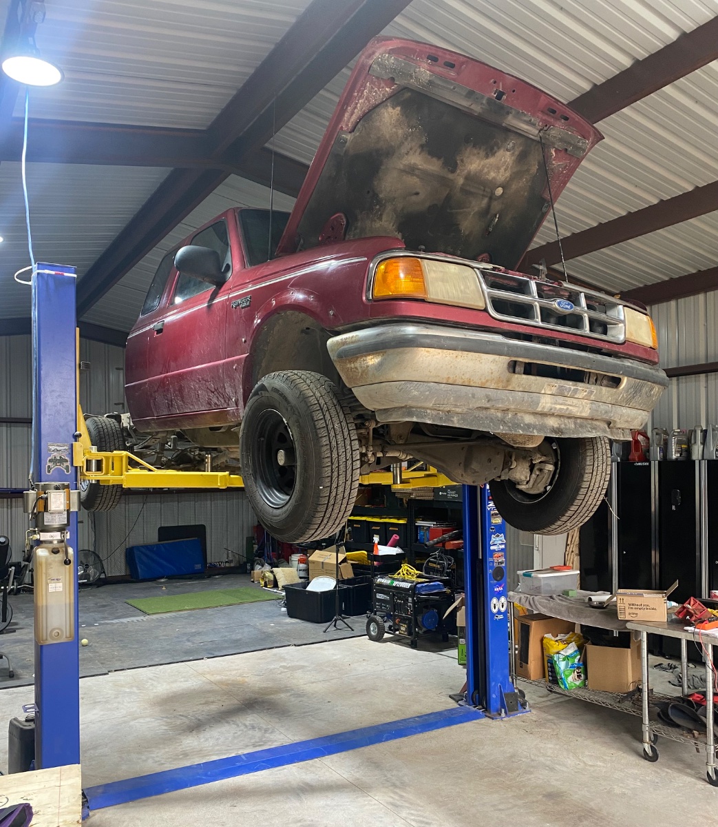

In the shop and out of the dirt.

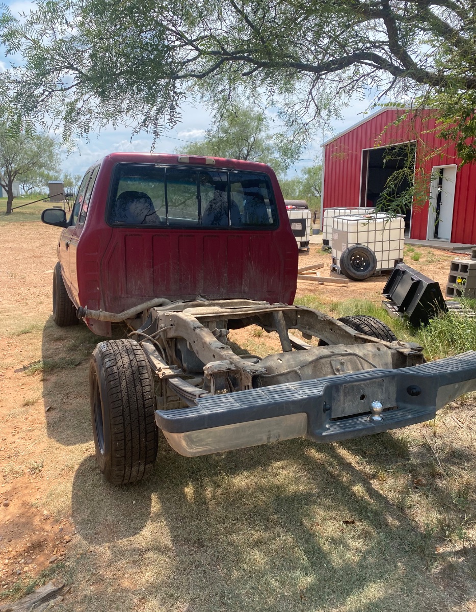

I sourced a 1995 donor today - 4x4, 4l, manual, engine blown. $600. Pick it up tomorrow. :yahoo:
Looks like a good starting point. 93-94 are kind of oddball/unique years. Dash and door panel stuff pretty much can only come from 93/94 donors (at least for power windows and doors).

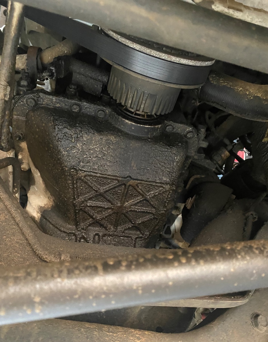

I think it has like 180,000 miles. Planning on doing the rear seal, front seal, oil pan gasket, valve covers.

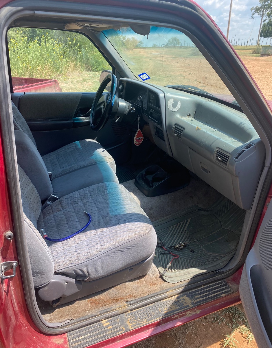

Current parts that I’ll use from the donor.
1. Transmission
2. Drive shafts
3. Shifter and floor plate
4. Clutch/brake assembly
5. Clutch hydraulics - guy said it had new master and slave installed as well as reservoir.
6. ECU
7. Guy said clutch and flywheel were also new. I’ll inspect and see if I’m reusing.
8. Starter
9. Crossmember
Huge bonus parts -
1. windshield with no chips or cracks from 1995
2. Bed that should be repairable and usable unlike the 1994
Probably other parts as I realize I need them
1. Transmission
2. Drive shafts
6. ECU
8. Starter
9. Crossmember
Huge bonus parts -
I don't believe the ECU will work in your 94. 94 was ODB1 and 95+ is ODB2 among other things.
