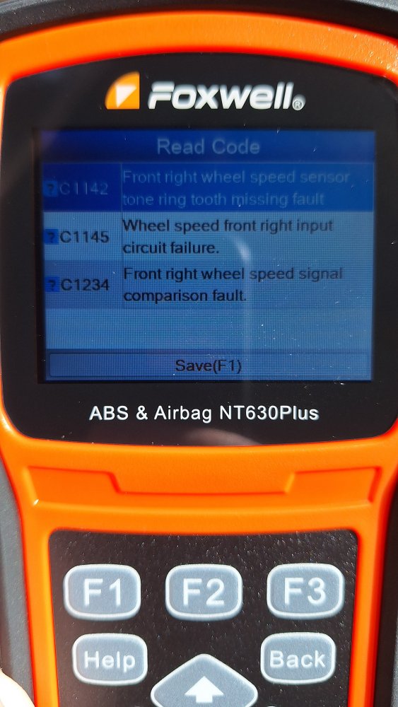

My 2005 Jaguar XJ8 is giving me an ABS light. I replaced the right front wheel speed sensor but I'm still getting a code. I scanned the ABS codes and got:
C1142 - Front right wheel speed sensor tone ring tooth missing fault
C1145 - Wheel speed front right input circuit failure
C1234 - Front right wheel speed signal comparison fault
I took the hub assembly and looked inside the port for the sensor and saw this:
I'm a little confused by this because I was expecting to see metal vanes, not a smooth surface. Seems unlikely to me that this could be bad, so I'm looking for input from anyone that has dealt with this type of tone ring before and how I can determine if it's bad.
