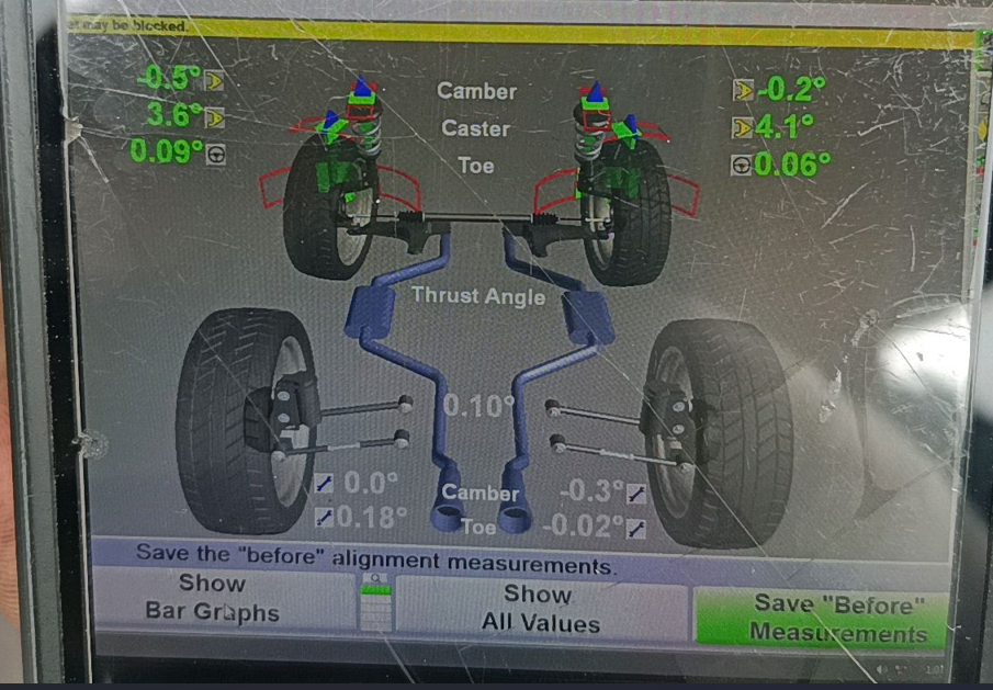

Took the truck to an indie shop but after 3 attempts the truck is pulling slightly to the right. They didn't adjust the passenger side LCA rear camber bolt for whatever reason, but I mostly sus they had no clue what to do with it. It's still askew from when I installed it. I am wondering if I adjust it to where it was, will it throw off the alignment?
Here are the alignment results, does this look aok cos I don't know how to read this and make sense of it.

Maybe me, but that camber/caster seems like it could cause a little pull.
Are they supposed to be identical so that equates to no pull to side?
I think there is usually an adjustment to one side for road crown. That assumes you're driving on properly crowned roads... Pretty unlikely IMO
