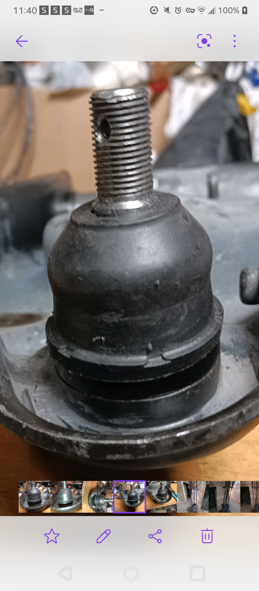

Are the cup type covers on the ball joints supposed to include a retaining ring, cos these Moogs don't. I am reusing the old LCA as seller sent a different part and pressed new bushings and ball joints in. .

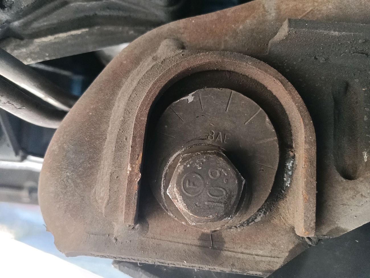

Mark and note the REAR PASSENGER LCA bolt before removal!! It is a factory caster (I believe) setting. I just marked it and put it back there when finished.
I forgot to do this. Is it only the passenger side that's has caster setting, and driver side does not?
On mine, yes. If you didn't clean the area, you probably can get a pretty good mark of orientation from before removal. If those aren't factory LCAs, or the previous owner put in new bushings, it may be guesswork anyway. Hence the upper cam bolts and final adjustment when you're finished.
I have torqued U/LCA bolts to 100-110 lb-ft. Installed new adjustable type camber bolts for UCA. I see the LCA rear camber bolt (it's the only one, the front is normal type) has markings. I tried my best to line up the oblong washers best as I could to where they were previously. I am just wondering how I should take the said markings into account? Do shops adjust this particular bolt during alignment? Is this bolt common in other cars/trucks or just unique to the ranger? (I always do self alignment for my cars but if I can't quite get it will head to the shop, especially because I never new of this camber bolt, just in case it throws a monkey wrench in here. None of the vids mentions this LCA rear camber bolt-I heard if first from you, then I had to go back and look them over. I dissambled the passenger side at night so I didn't notice)
I installed this camber bolt by inserting from the rear to the front.
About to start front suspension rebuild
The best I could find out is that particular passenger rear LCA bolt is a "factory caster setting". So I just put mine back where it was. To be fair, mine has 230k more miles, so it was very obvious where it went lol.
The factory UCA bolts were also preset, I believe, by that trapezoidal washer. So I think if you still had stock UCA and messed with the lower, it could jack up your camber/caster a bit. However, since you're replacing the UCA and putting in cam bolts, you should be good.
I ended up paying $100 for discount tire kid to "align" it. I took the print out home, fine tuned it myself, and took it back (they offer free rechecks for 30 days). Their computer is way too lenient on "acceptable" ranges. I think it took three total trips, but the last two they didn't do anything, just put it on the rack and said it's good, but I got the reading and fine tuned some more.
I'm assuming that's what others mean by "toe and go" shops, they don't touch the camber/caster much, idk. I'm glad you got that all done though, I think other than the spring my biggest PITA was that bolt, trying to torque and keep it from moving.

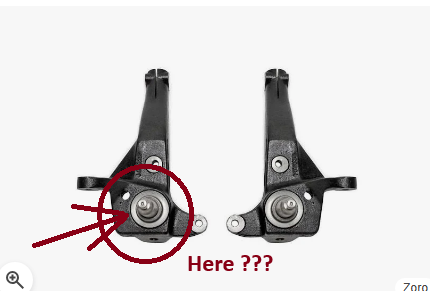

Everything wrapped up decided to twist the wheels at 3&9 o'clock and 12&6 positions. The former is firm, no movement. The 12&6 position has a slight play. Is this bearings that are worn out or...?
check for wear on bottom side of the spindles where the bearing races are. take the dust cap off and check for movement when you do the 12 & 6. it won't be much even if worn.
did you install new bearings? if yes did you seat them to 25 ft lbs then back off and retighten to just a few INCH pounds?
"...spindles where the bearing races are..."
Did you mean here?
"...take the dust cap off ..."
This one right?
That'd be the dust cap.
IMO, the only way to find minor wear there is to take things apart. If you finger catches on the spindle surface, it's worn. The bearing themselves is far more likely.
You might be able to see something with the dust cap off and wiggling the wheel.
Might wanna have an extra dust cap on hand. I don't think I've had one come off without tearing it up.
the bearing races are harder than the spindles. the spindle can wear enough to allow the races to move.
the wear will be on the bottom of the spindle. the nut being tight or loose won't matter because the spindle is smaller than the bearing race.
yes, that dust cap.
