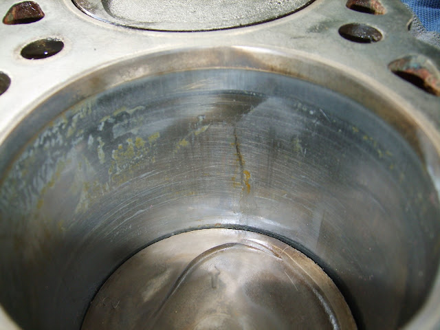

hmmmmm went to check to find out what happen last night had no compresion on 3 and 4 put a scope to see if there was a hole in a piston no thank goodness pulled vavle cover all vavles working right pulled head it was blown out in between 3 &4 so now getting new head set

Unless this is a very high performance build (over 350 RWHP) don't bother with the 1035. I ran the 8993 with 28-29 psi and it never blew. The cylinder wall, however did blow.
