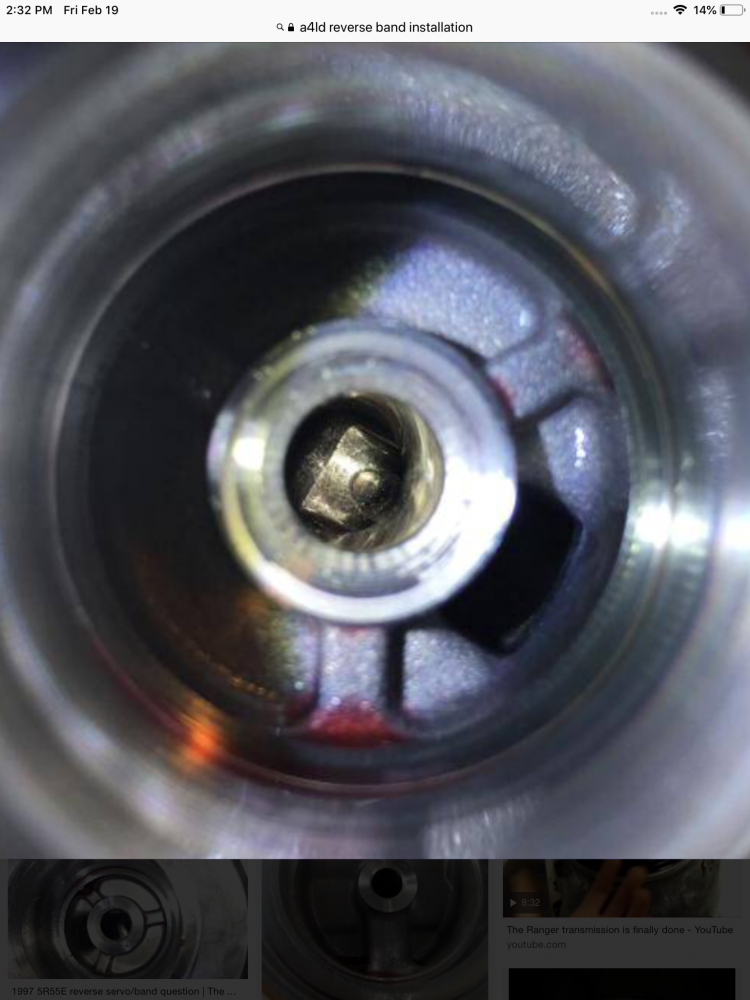

This happened to me when I took the transmission out to inspect, clean, and change the filter... I rebuilt the engine myself and only made some basic adjustments. I inspected the reverse servo, removed the piston, and heard a metallic noise, like something had come loose, and it scared the hell out of me... I decided not to go any further, put the servo back on, closed the transmission with the new filter, and prayed to God it would work again...
After I finished rebuilding the engine, I tried shifting it into reverse, but to no avail. I can shift into all gears, but not reverse...
Now, seeing your post, I'm hopeful I won't have to disassemble the whole thing... Do you have any more information on how I can reattach the servo pin band?
