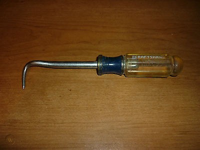

This tool works very well at sneaking in behind a trim panel to hook and/or leverage a clip loose without damaging the panel:
Officially it's called a "cotter pin removal tool", but it's my main go-to tool for removing a friction clip held trim panel.

a drum brake adjusting tool works, so does a door trim bent screwdriver type of thingie.

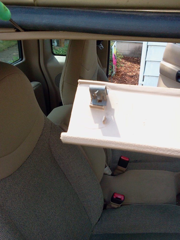

holding a trim piece to show about where the tab is

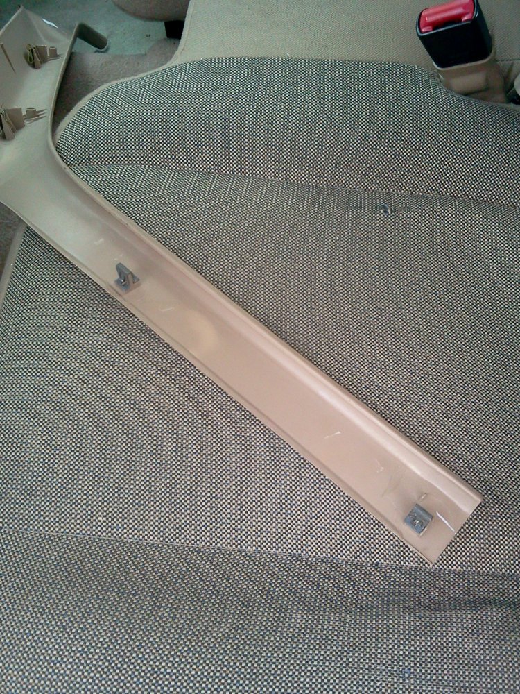

the removed pass side trim

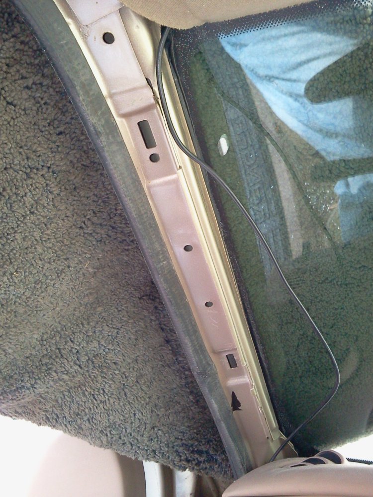

driver side A pillar, has factory holes, round for rivets, rectangular for locking tabs

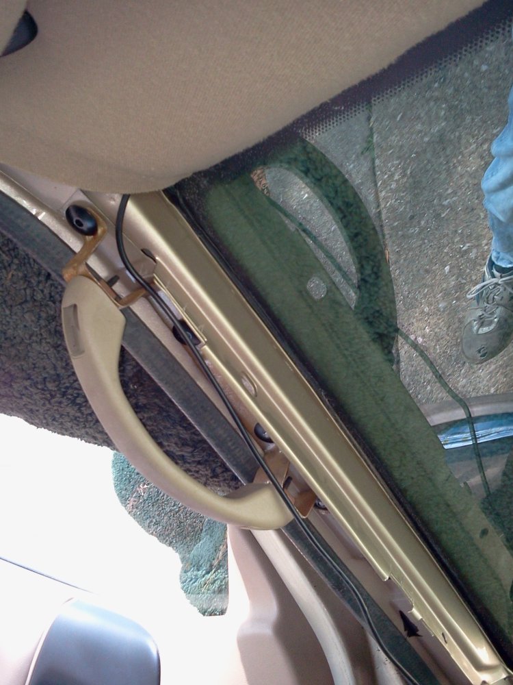

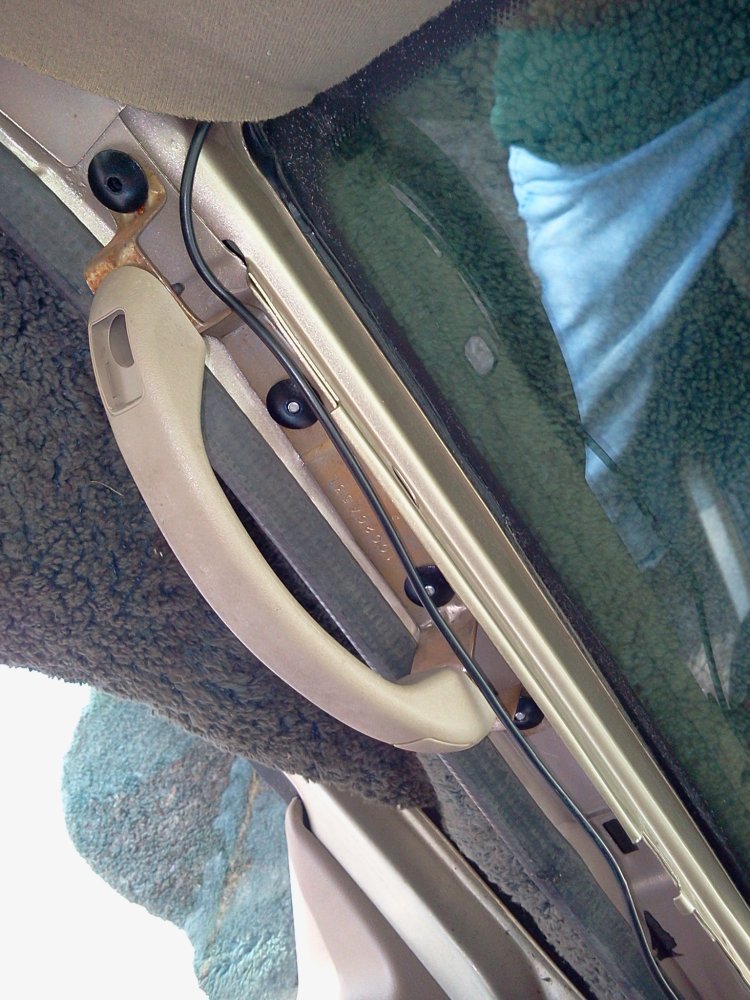

2 of the bracket, put the trim on before the handle
ignore the wire, it's not factory.

I do believe I used a plastic trim tool on the roofline clips... the a pillar clips I just pull it away from the a pillar.

Any chance you could post the part number for the grab handle bracket? The pillar trim could be modified, Replacement grab handles are available, but that bracket... Not finding it and scrappers don't list it. For me it would be a 120 miles to roll the dice at someone else's scrap yard as none of my rangers have the handle, And I don't know about dragging another one home until I get rid of some.
the brackets are different left & right.
trim must match body style, reg cab or extended cab. they both fit the A pillar but not along the top/ceiling.
old trim can be made to work, but it doesn't lay flat at the top unless a hole is cut into it which exposes the bracket.
