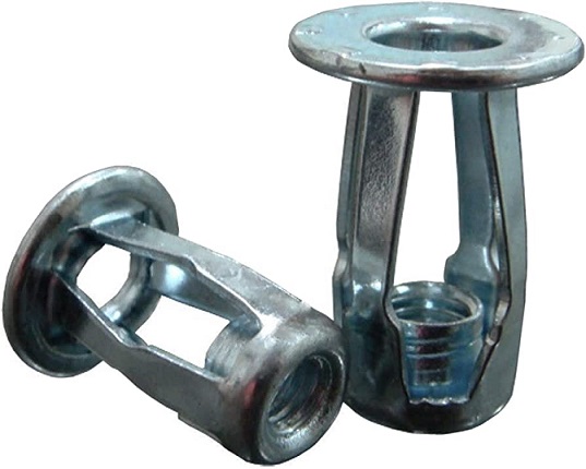

I think a stock overhead grab handle would work well, but I would suggest that you solidly mount it using expanding nut inserts, also called rivet nuts or jack nuts. This'll let you mount the handle with machine thread bolts; very strong.
Here's an example pic of one of several styles:

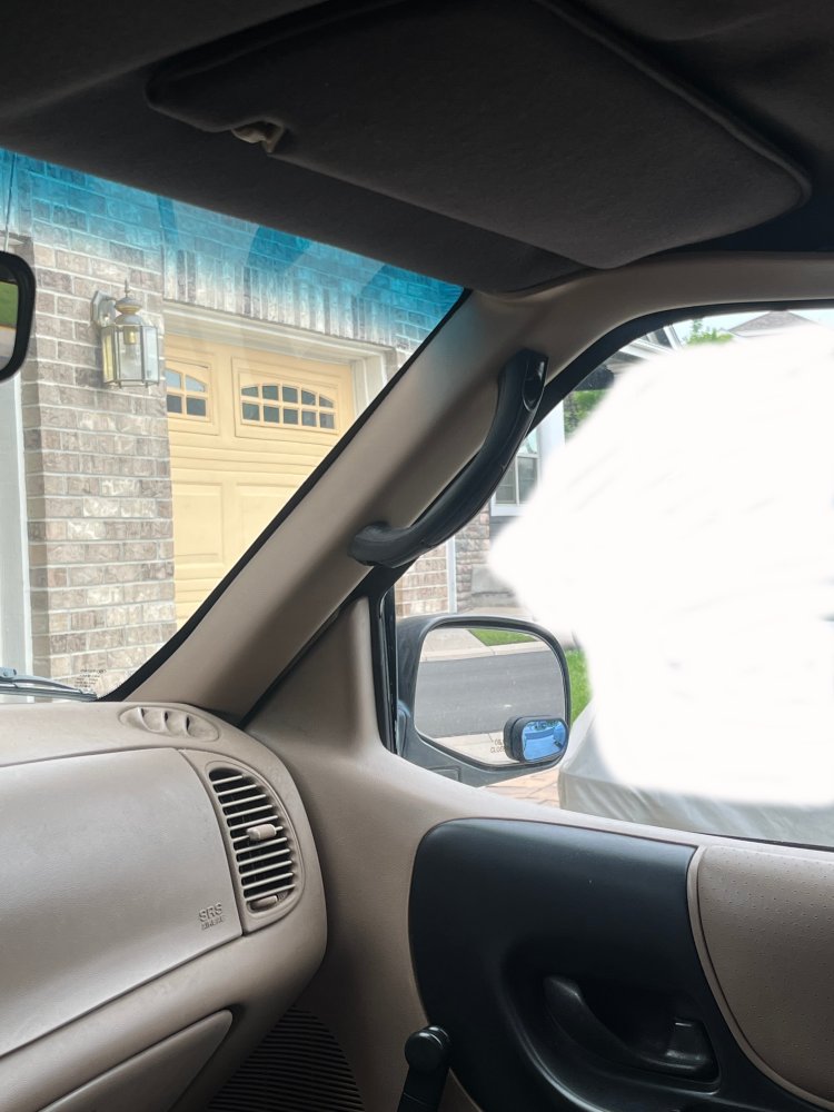

I took a chance and drilled though the plastic trim since I don't know how to remove it. The top hole went into metal so that bolt is secure. The bottom hole went into nothing! Still I pried away the plastic trim to install a nut on the back side of the trim. Though not ideal, it turns out this works well for the wife. She just needs the grab handle for balance while entering the truck.
Anyone know how to remove that trim?

You just grab it with both hands... high and low. Then pull it away from the a pillar. It's gonna sound like you breaking it... but you most likely won't.

stand outside the truck, pull the trim down a bit, insert bent screwdriver near front & rear to push the 2 metal tabs.
then the 2 tabs on the A pillar pull out.
the reason for pushing on the metal tabs is the plastic they are attached to can break off easily.
it helps to have a light to see the tabs if you're outside on a bright day.
