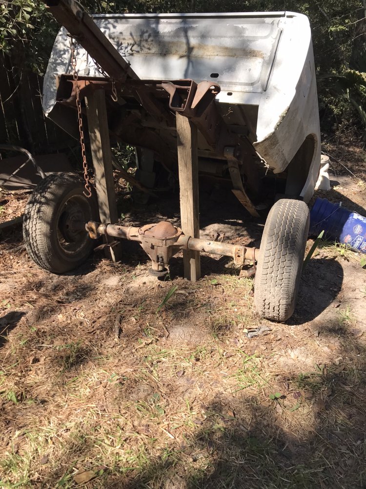

Hello all. Yeah another new guy but I would like some info and looking through most of prior forums not really sure where to start. I have a 1931 model A that I would like to possibly use a 8.8 or a 9” rear in. I’ve got the original banjo axle but wish to use a 302 and c6 transmission and not sure what direction to take. The model A rear body width is 43 inches and the axle I have off the ranger is 50 so 3” on each side seems like a good fit. I got a ranger bed in trade for a paint job I did but never pulled the axle out till past weekend. The old man didn’t know what it was, He
welded a tongue on the front and used it as a trailer. So if anyone can help I sure would appreciate it. My other truck I have is a 80 f100 ranger xlt. It’s axle is too wide or I would of just used that.

I found this info here so I’m still researching looks more like the axle I have is a 7.5 so this Wednesday when I get back to my county house I’ll do what you said. Thanks a lot Ron!!

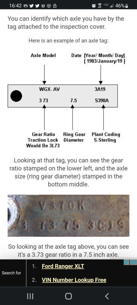

You might get lucky and find a tag on one of the differential cover bolts. The code on the tag will yell you what axle you have. Here's a helpful screenshot from our axle tags and codes article in the tech section.
I found an existing article here on this site that went into detail but you nailed what I need to look for.
