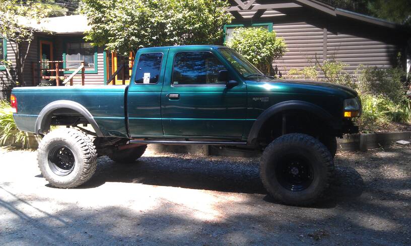

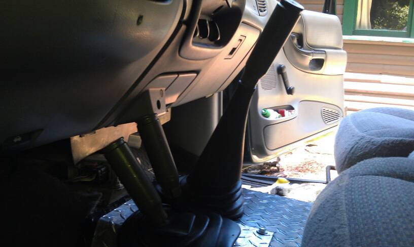

Well, the manual is in. Seems to run good.

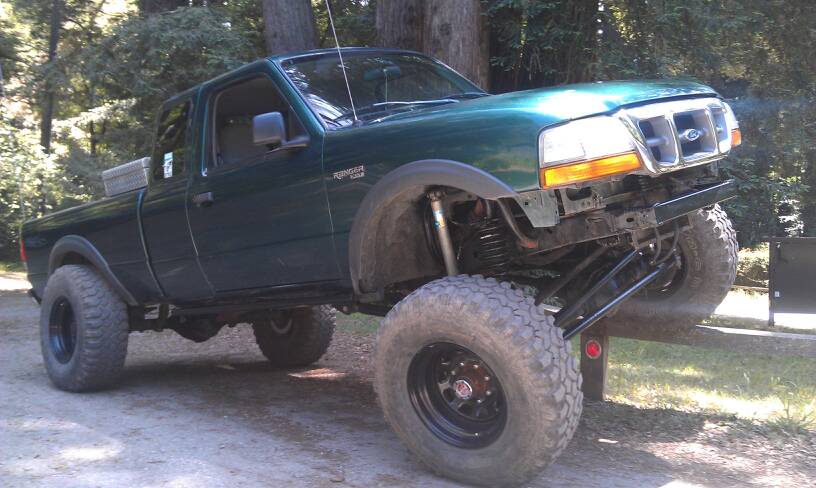

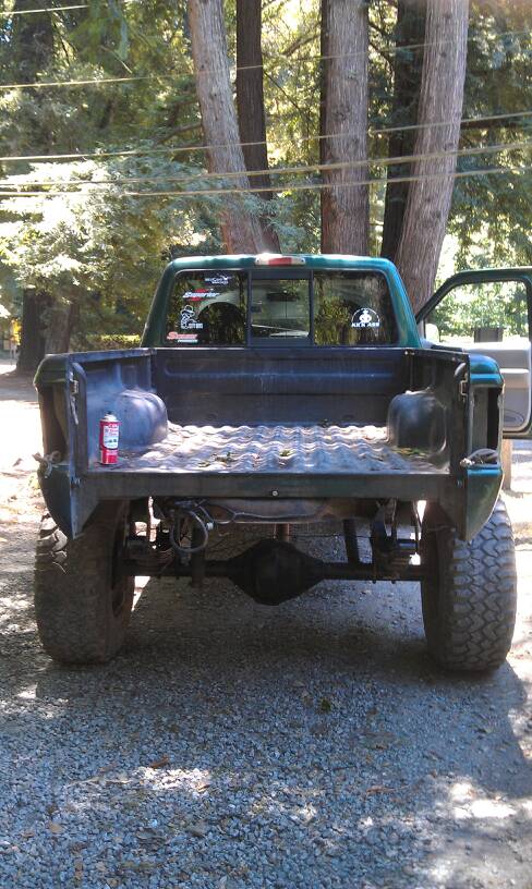

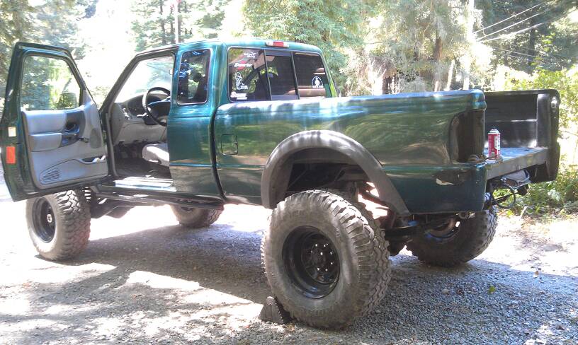

So I finally did the 63" leaf spring swap. It sits level now. Not sure I like it. When I made my shackles I made them adjustable. Glad I did. Also want to take a couple of leafs out. So that will lower the rear a little.

What aren't you liking about the swap?
Just how tall if is. It's pretty stiff now too. Makes for a bumpy ride. I can fix that by removing leaves though.
Sent from my ADR6350 using Tapatalk 2
Oh ok I gotchya. Are your shocks the correct length now or are they too short? I mounted mine on top of the axel at a angle when I did the swap.

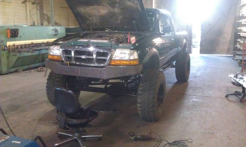

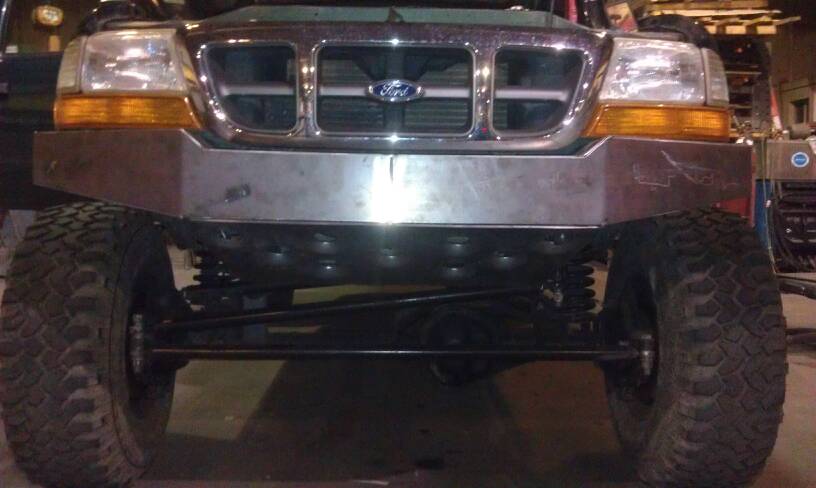

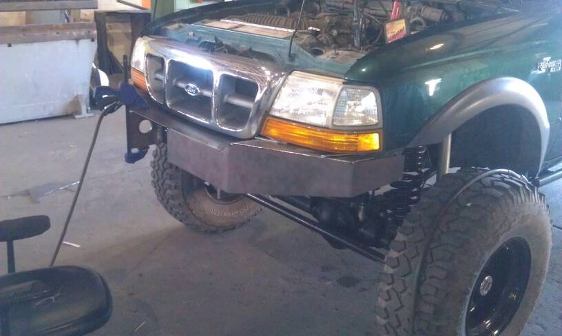

Started my front bumper last night.

Looks good man! How thick of material is it?
3/16" and 1/4" everything but the skid plate is 3/16". The mounts are 1/2"
Oh ok. I've been thinkin about building one with the same materials and close to what you've done. Yours looks like it's turned out really good!
