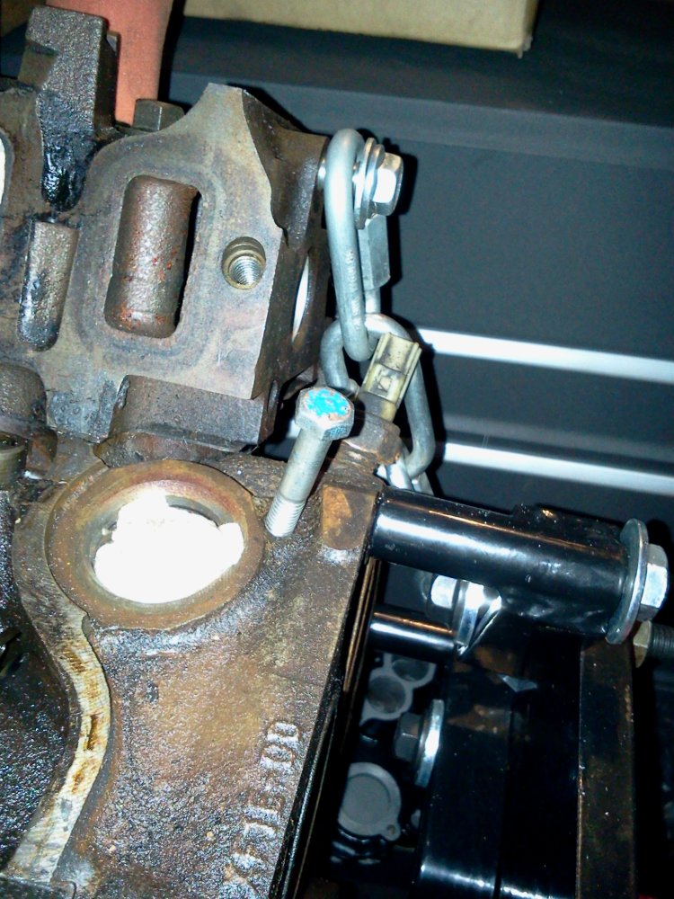

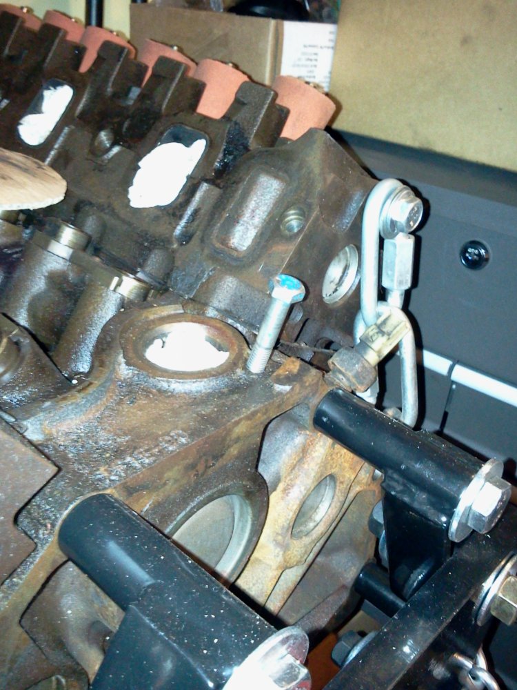

the hole for the hold down bolt is at an angle.
the big washer contacts a nub on the block and the ring on the sync unit.
so the washer also sits at an angle, with a big gap.
kindly ignore the custom low tension valve springs.
they are actually parts from a copier fuser, slightly modified.
