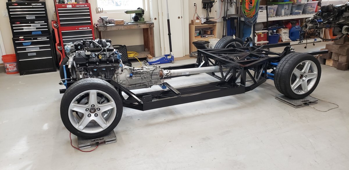

Retired engineer with too much time on my hands, lol. Completed tube chassis with a 2017 3.7 mustang drivetrain swap.

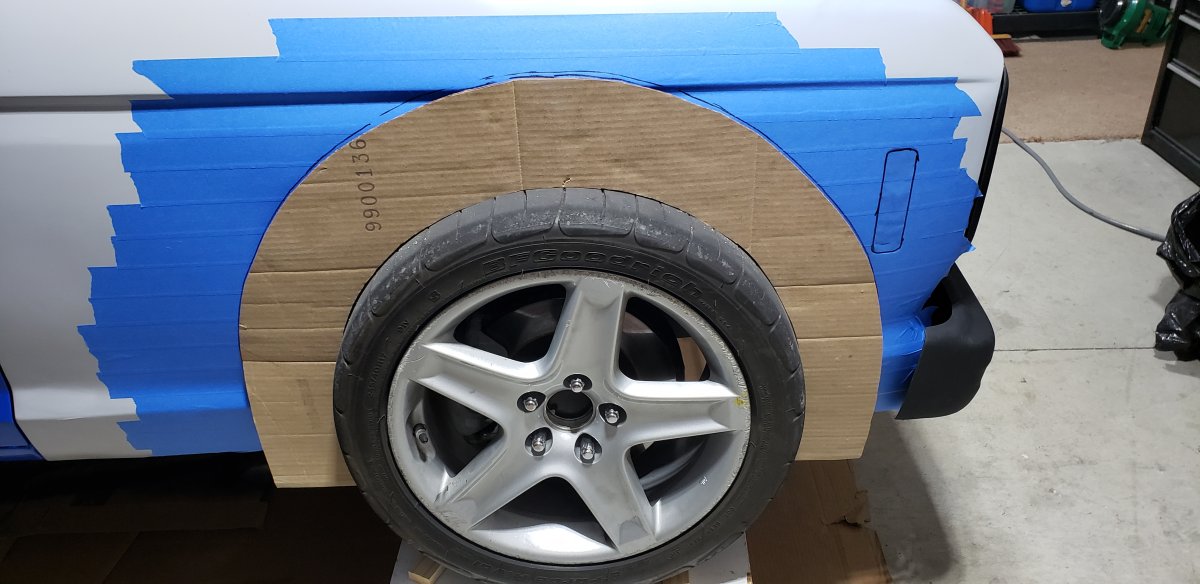

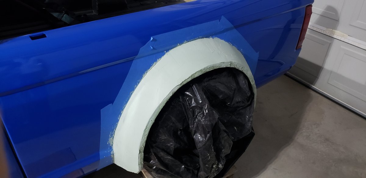

Working on a composite hood and fender flares. Here is the process used to build the fender forms.
I will post pictures of the forms and final composite pieces.
