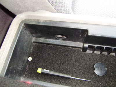

Looked at some of the posts and removed the little cap inside the console but there is no bolt behind it (am I looking in the right place?).

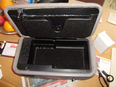

I have enclosed some piccies and any assistance would be appreciated please?
Tired Armrest

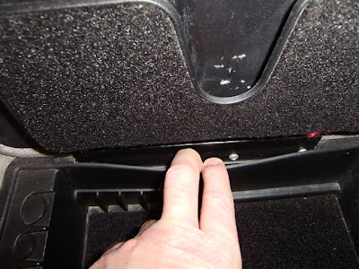

Broken Bracket

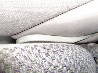

Is this where the bolt should be?
That is exactly where the bolt is supposed to be. If there's no bolt what is holding the arm rest on? Now it's been a while since I removed mine but I believe it's a torx screw. A T-40 maybe???
Bump
the 98 and up had supports on both sides, they are bolted in the bottom of the 60 seat
On the 98-01 rangers (possibly others), the bolt is a torx that is located at the pivot points (the plastic shown in the second picture). The bolts are on the outside of the console pointed in, not accessible from the inside, and are shoulder type bolts. You get at them by removing the outer plastic covers of the mounts after you lay the seat as far back as possible. The plastic cover of the mounts should slide up the mounts to come off.

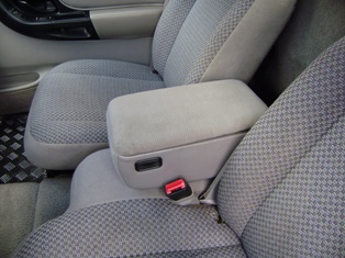

center console on my 96 ranger is bent to one side. I assume that this is either the console itself that is bent, or the spot where it anchors in the drivers seat is bent. Anyone have experience with this? Is there a fix for this without replacing parts?
there is a hex bolt in the console holding it to the seat that i have seen some peoples come loose and it make it wobble alot and not sit right it could be that
this is how to get to it
I'll take a look and see what I find out. It doesn't seem loose, but if I pull it off I might get a better idea what is going on.
