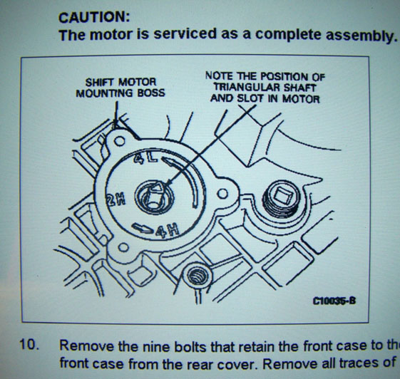

Assuming the truck is stuck in 4wd hi or low, and I remove the transfer case motor, how do I manually switch it to 2wd? If I do that, will the transmission also be able to shift, or is there an electrical signal that the transmission needs to receive to know drive normally?

My 93 shift motor just attaches to a triangular shaft on the transfer case, which it turns while shifting to each setting. I believe the motor is just there to turn it, in leu of a manual shifter
If you pull it off you should be able to know by looking at its current position if it's where it should be
