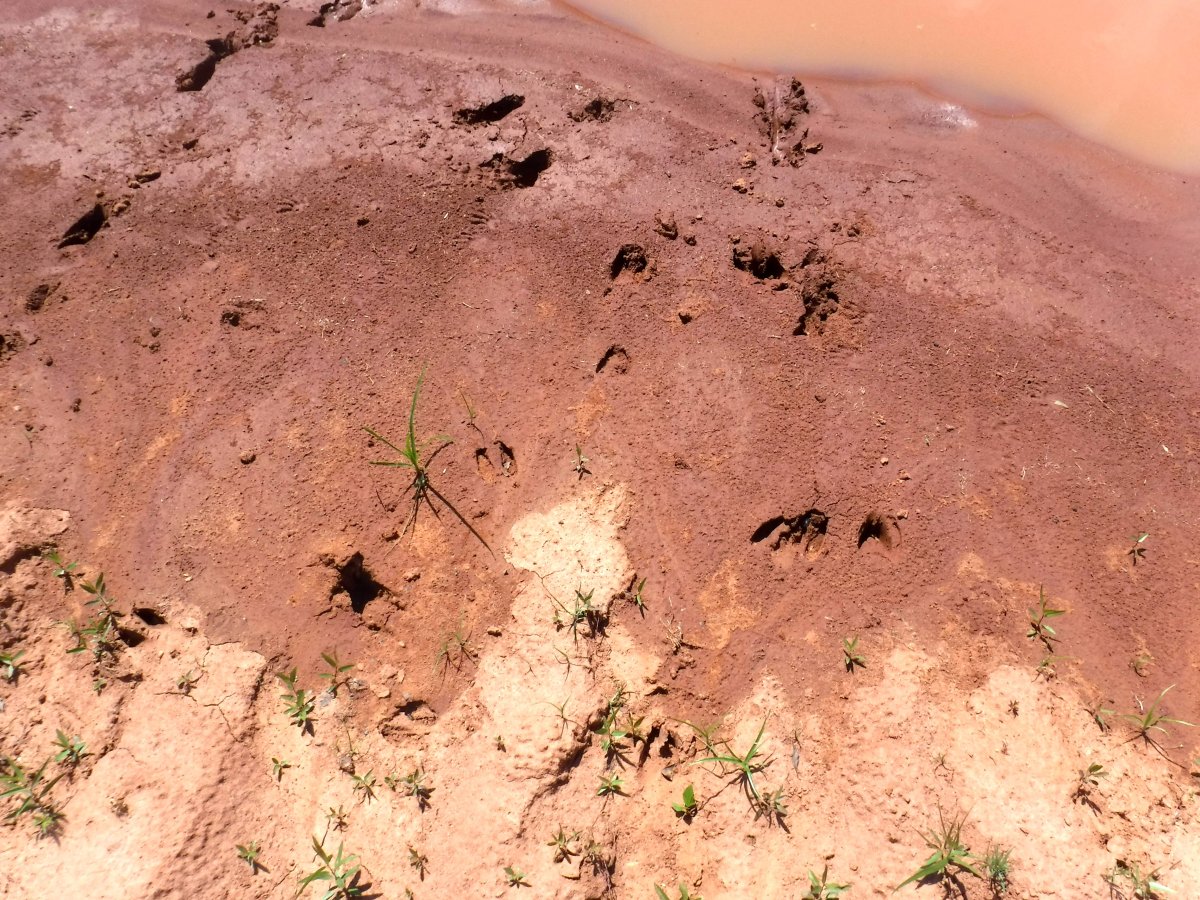

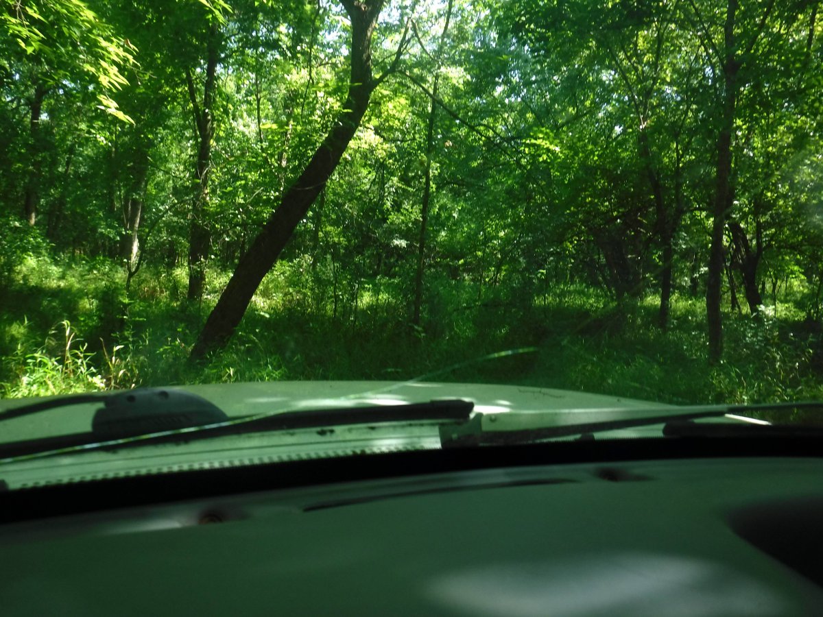

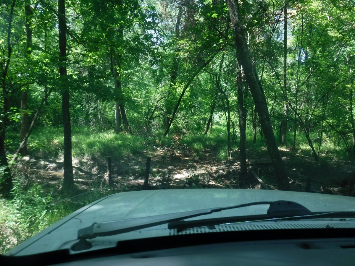

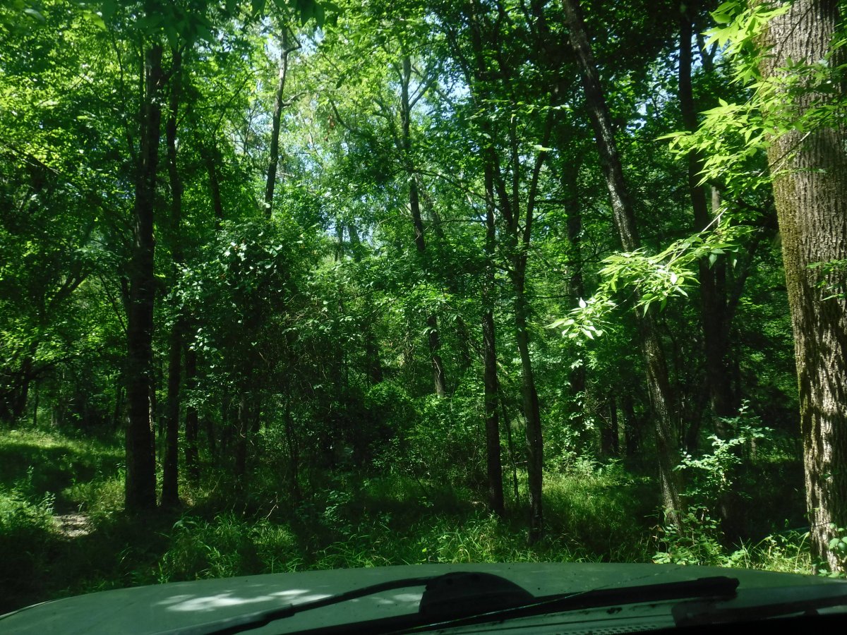

I don't do near as much 4 wheeling but I know what's there, and with limited slip it will do a lot of dragging and slipping, and you can't get through those woods without doing a lot of turning
I did manage a trip out there today, although it's like a jungle ATM, and I hadn't been through there in a while. I was surprised to find the ditch still had some water in it. Not surprised however to find the pond didn't, that was not the location it was supposed to have had, at least there's some deer around.
I wanted to get some photos of the cracked dirt but managed to leave that behind :/ I can guarantee you will feel every bit of the limited slip slipping on that dirt just like you would rock or cement

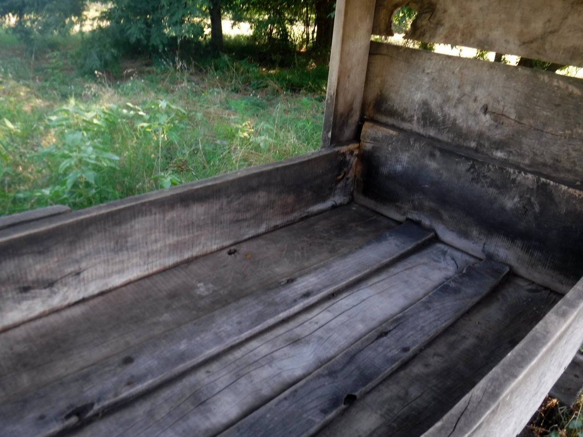

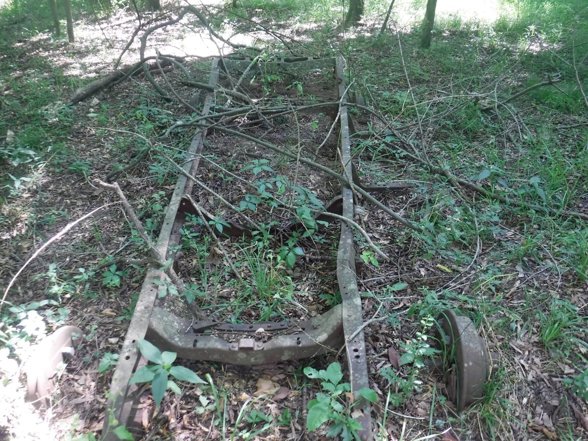

I believe that's an old Model T car frame, I can recall it having wooden slats across it while serving as a farm trailer
