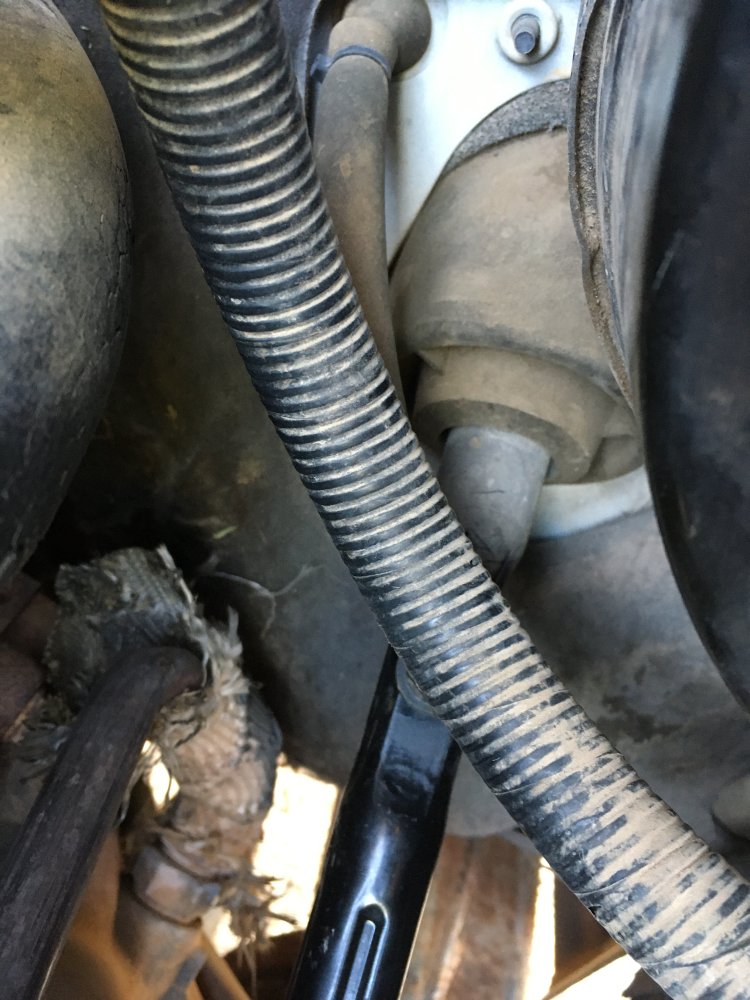

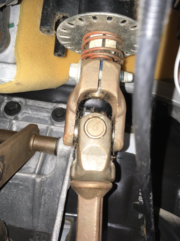

When I shake the steering column in the engine compartment, the movement seems to be at the firewall. When I grab the shaft inside the cab, under the dashboard, it doesn't seem to have movement above the universal joint, at the end of the intermediate column, just below the 'silver' disc (see attached photo).
Here is a link to a Ford parts diagram:
It doesn't indicate what image #15 is, but #12 they call a 'lower bearing sleeve'. If I interpret the diagram correctly, #12 would be between the intermediate shaft and the upper shaft- not my source of movement/wear. When I look up there I can't even see anything like that, perhaps it is above the 'silver' disc? It is hard to see what is at the firewall. I guess I could make the effort to take all the molded rubber and padding out and see better. From the outside a molded housing (second photo). Is there a bearing inside it??

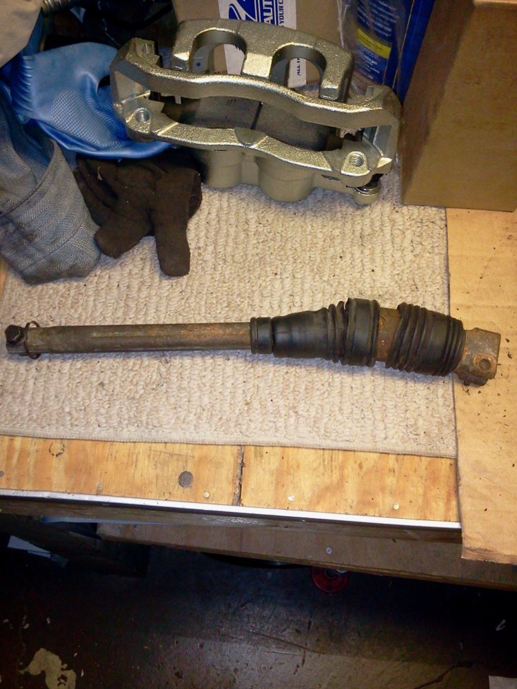

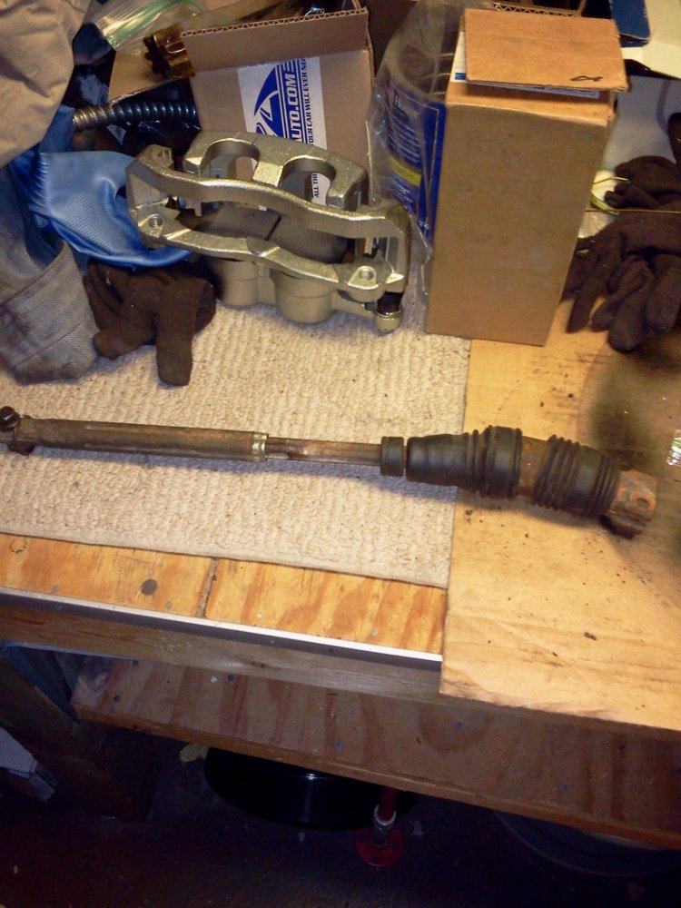

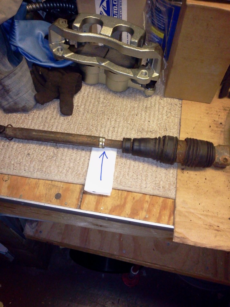

check for play on the lower shaft at the slider bushing, it's inside the bigger part.
a few thousandths here will be about 1/2" at the steering wheel.

what I pictured is 14 in the first pic, 13 in the 2nd.
U joint under the boot, the column collapses/expands about 5 inches.
Thanks. #15 being a 'big rubber boot' isn't what I wanted to hear; I wanted it to house a stout bearing so I could replace it and my problems would go away. I've replaced the lower shaft, that was my first move to eliminate the play. My extra simple logic said: that's where the play seems to be, it must be my problem, $165.00 later, I still have the play and I can still grab the steering column under the hood and it has lots of movement.

the column moving around a bit at the firewall won't affect steering play. rotation, or rather the lack of rotation causes play.
I would separate the lower shaft assembly at the upper end. that's the left end in my picture.
that will effectively isolate what's under the dash from what's under the hood.
grab each end with something solid, lock on with visegrips or whatever.
rotate one end then the other, one of them should reveal the play.
then just move the tool down/up the works one piece at a time.
