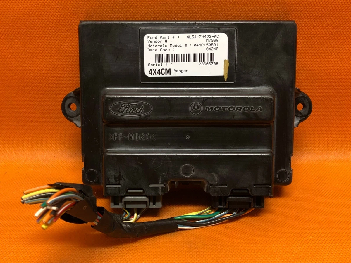

In a 2001-2005 Ranger 4x4 the 4x4CM module is the usual issue
In a 2002 it will be behind the passenger side kick panel
Looks like this: https://i.ebayimg.com/images/g/tM8AAOSwYRJdAqjc/s-l1200.webp
But different part number
Used are a big roll of the dice, since 2001-2005 4x4CMs were known to fail
Ford redesigned them in 2006 but they are NOT backwards compatible, so you can't use the new design
Thanks for your advice. I located the module, where you said it was. Can new ones be purchased anywhere?
Yes, new and rebuilt are available
Fords base part number for 2001-2005 4x4 CM is 1L5Z-7E453
You will find them listed as 1L5Z-7E453-AB to 1L5Z-7E453-AE, i.e. AC, AD then AE
When Ford "revises" a part but doesn't fundamentally change it then they change the last 1 or 2 digits higher
AA, AB, AC, AD AE, ect....
1L5Z-7E453-AB to 1L5Z-7E453-AE will work for you, new or rebuilt
Engine size or transmission doesn't matter, works in 2001-2005 Ranger/Mazda 4x4's
They can be STUPID expensive, ignore those sites
$150-$250 is new/rebuilt average
Usually a core charge as well so your old one can be rebuilt
If you find a local autoparts store with one in stock, or can bring one in, then no core charge just an exchange
Dorman sells rebuilt 4x4CMs with part number 599-252
You can also try local wrecking yards, IF they have an exchange policy, about half the new cost, and you can bring your Ranger to the yard and plug in the new module to test it
