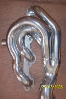

The big problems is that you are using a '98'. Going without a computer (EFI) is going to be really, really fun but it's been done. For the wiring I would go straight to E-Bay and pick up a Helms wiring diagram for your truck. Check out what all functions you will lose when you ditch the computer. The only headers made for the '98' and newer Rangers fit the 5.0 only and run about $750. Figure $2000 (?) for a set of 2" for the Cleveland that will fit.

It's not the under hood wiring I was concerned about but the elimination of the CPU and associated functions it now is used for. Things took a big change in '98', not like the easy to do earlier ones. Header picture is the custom 302/5.0. With the pipes in the correct radial orientation.
