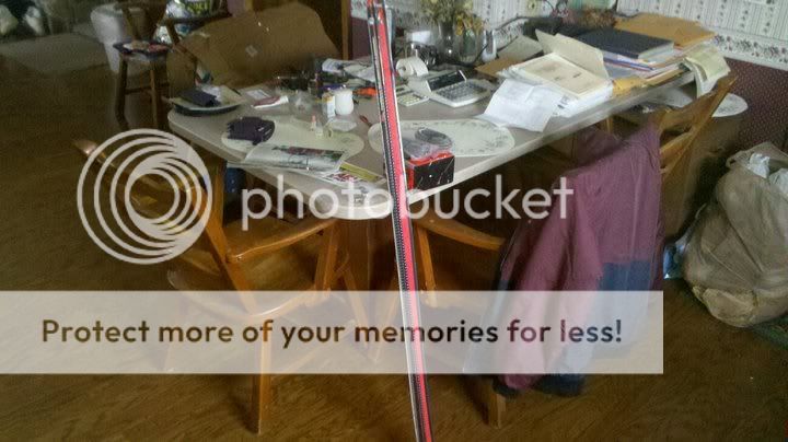

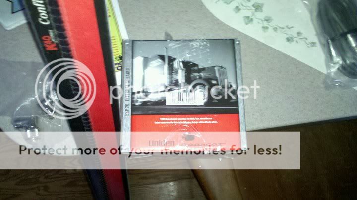

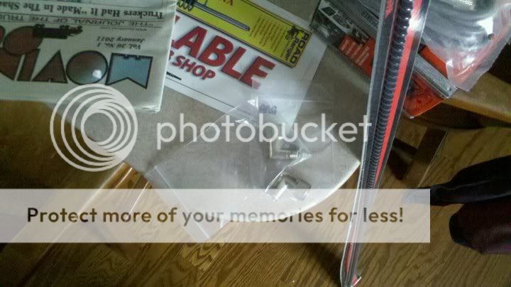

here is the stuff i got
4ft Astatic Superflex to match the other side
2 Right Angle Adapters
2 9ft sections of RG-8x
Uniden Bearcat 20 Watt External speaker
