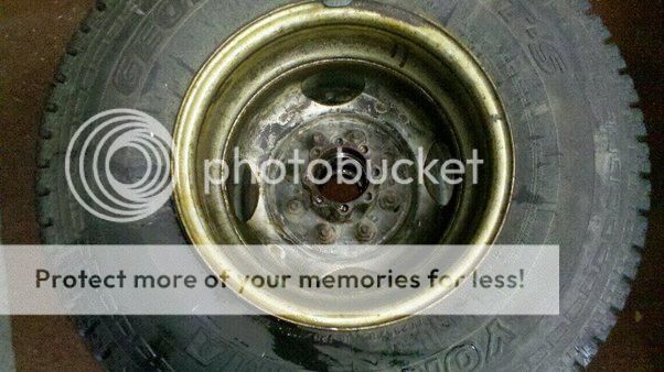

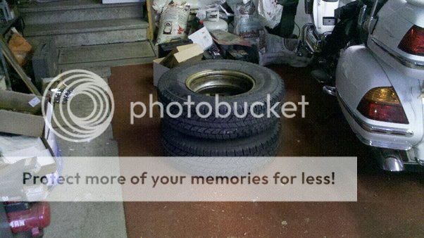

couple weeks ago i got the shackle mounts replaced , fixed my sloppy shifter issue and got 6 new Yokohama Geolanders mounted on it , been runnin the livin daylights outta her

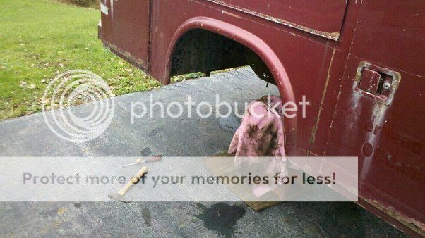

well i still have yet to get anywhere , but starting the 10th of this month i am diving head first into this thing , i have to currently stop driving it because the rocker panel is basically gone and the oil cooler is about to wipe itself out , so it is going to go under the knife and come out a whole new truck , there will be lots of pictures soon
The rocker panels disapearing is pretty common on those...I work at a bodyshop, we bandaided this thing a few weeks ago...basically just so the door would close and stay closed, there was nothing left of the floor either, guy had just set a piece of sheetmetal in there.

wow , mine isnt quite that bad , it is all still there just the cab corner and rocker aren't attached to each other anymore

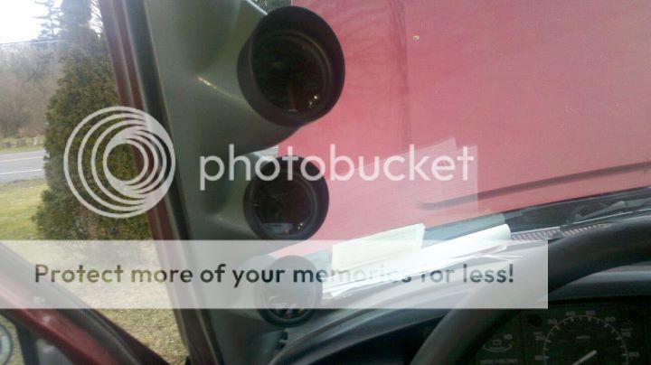

well it looks like i may have my explorer back this week so i can extend the time frame of this build to help keep the money flow nice and steady , it is going in the barn next week to start phase 1 of the build , i ordere $1200 worth of parts last weekend for this step , parts included :
- TS 6 position chip with Tony Wildman tunes
- Pypes Turbo back exhaust , 3 inch DP and 4 inch from DP back

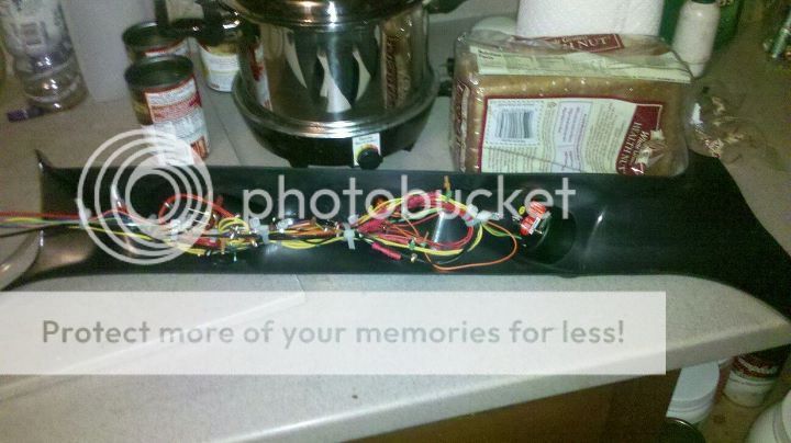

- Glowshift triple gauge pod with Boost , EGT and Oil Temp gauges

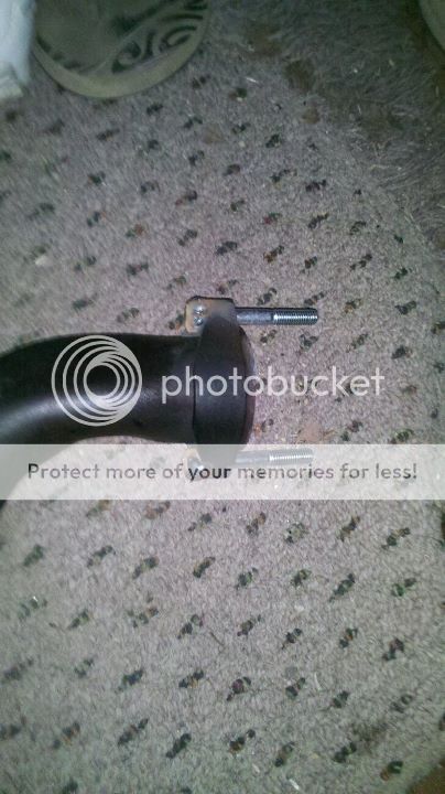

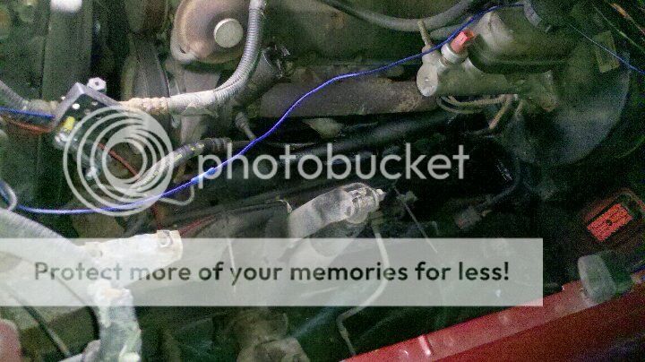

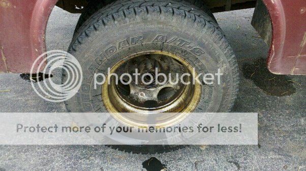

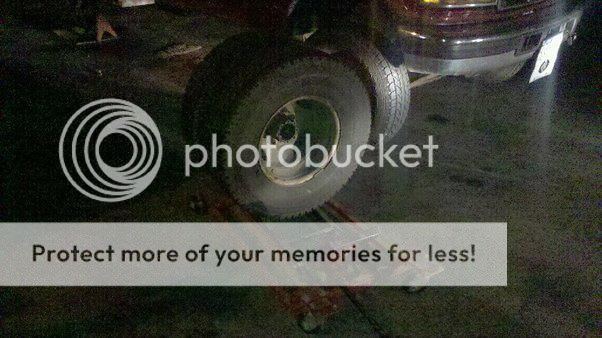

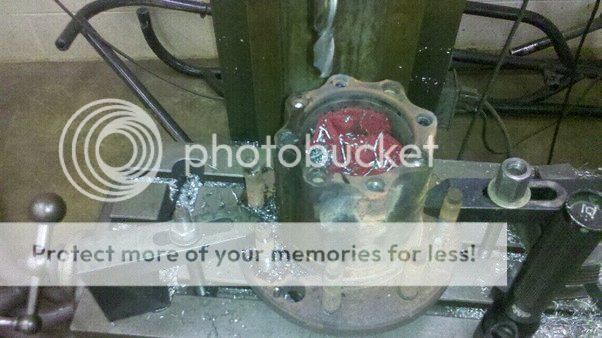

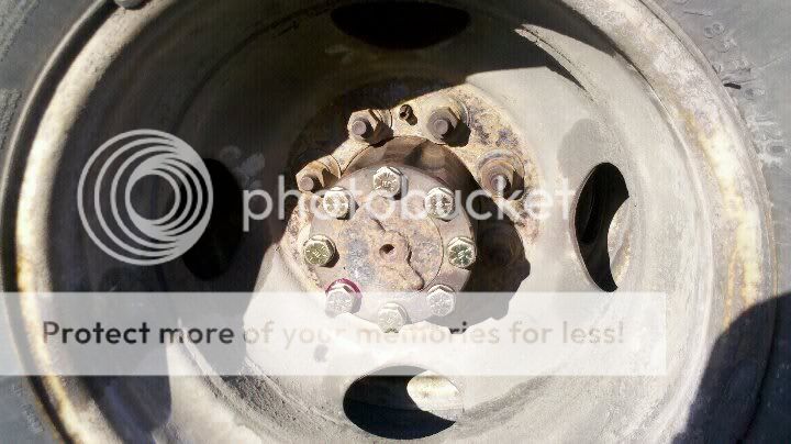

here are some pics from when my hub bolts broke the second time and the repair i made to it
97 F-350 Powerstroke Tow Rig (Non-RBV)
last pic shows the finished result , 1/2-13 bolts instead of 7/16-14, lockwashers and red locktite , torqued to 75 ft/lbs

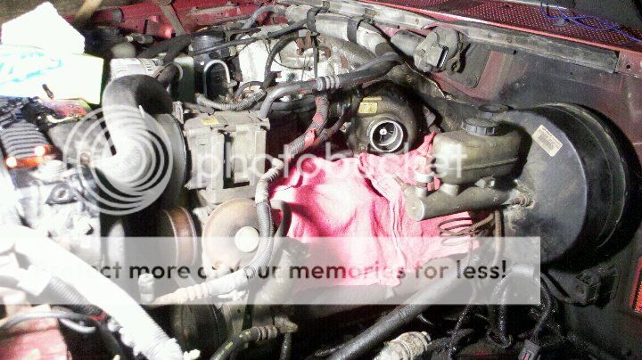

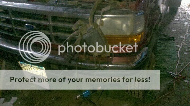

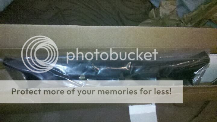

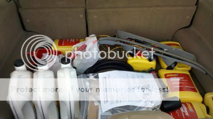

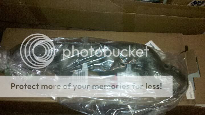

pics of the new parts for the truck

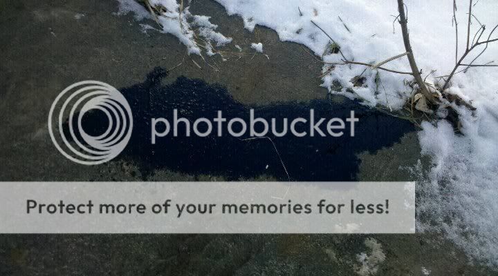

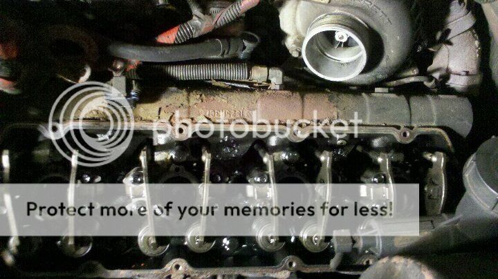

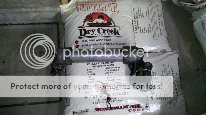

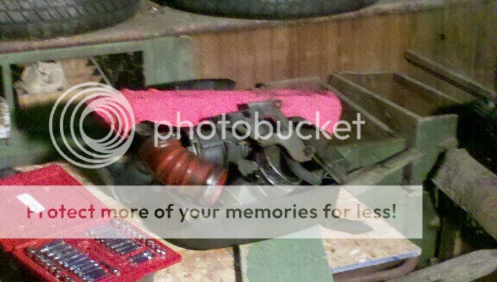

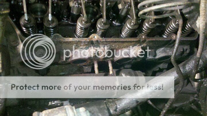

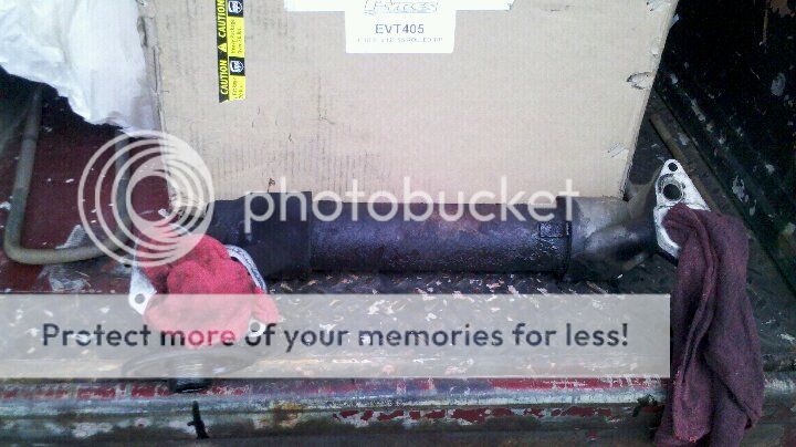

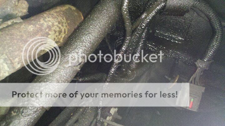

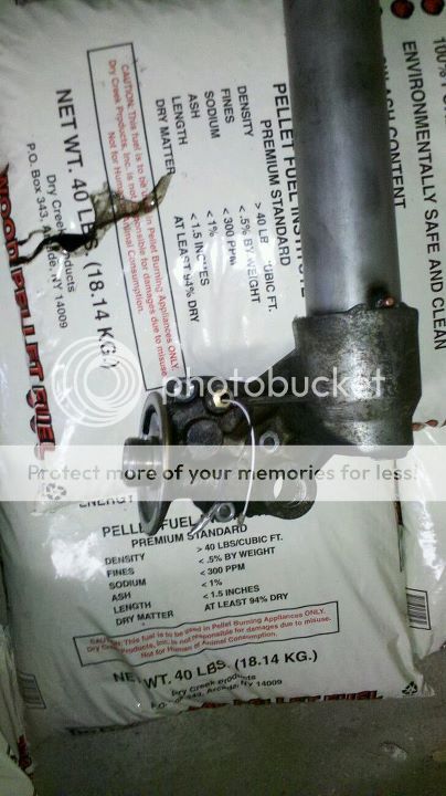

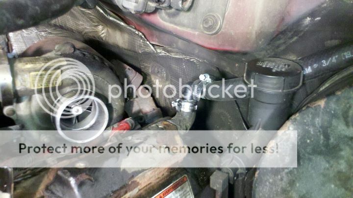

the reason i am rebuilding the oil cooler , it blew out the seals after i decided to park it until i could work on it

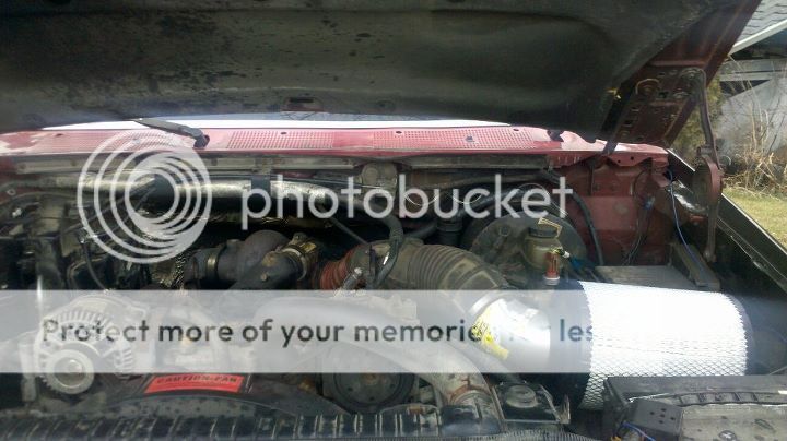

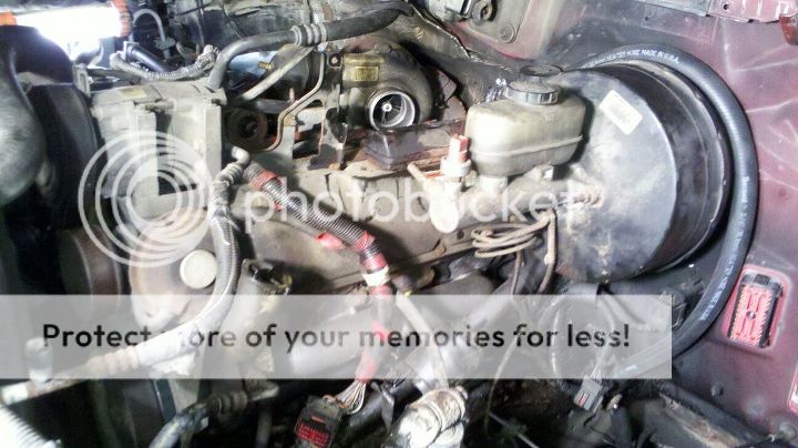

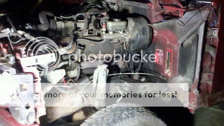

and here is the flood of pictures from what i have done in the last 4 weeks

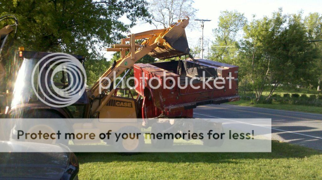

bed finally comin off

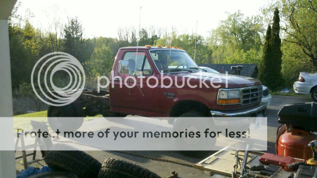

bed off , looks weird

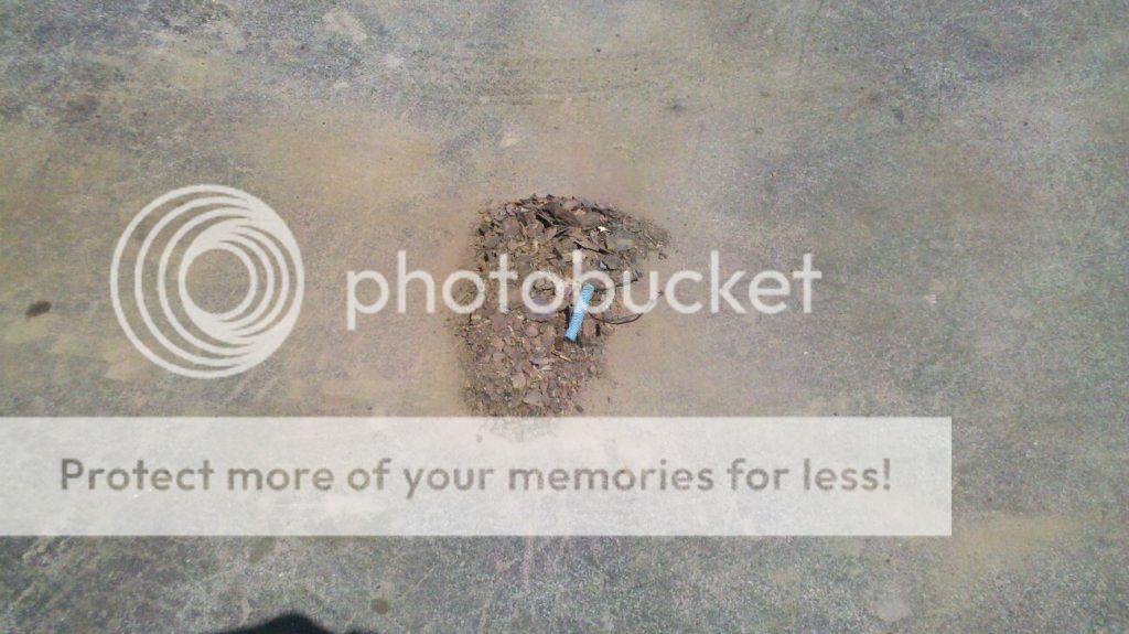

all the scale rust I have cleaned off the frame so far , not even a quarter done , I hate NY
