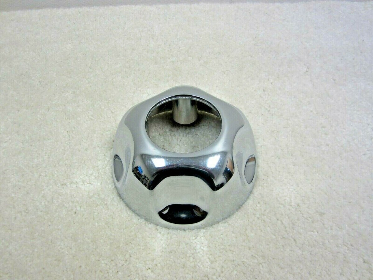

I know this isn't an Explorer forum, but the issue probably comes up with newer Rangers too. Does anyone know of hub covers that do work with manual hubs?
Some of the 4x4 hub covers have a hole for the hubs to stick out.

do some measurements and get out the sabre saw. I did the same with some centers off of some jeep wrangler steel wheels once.
I woulda recommended swapping rims to keep your original ones
The open-ended cover Ranger850 posted was used on '95-'97 4x4 Rangers... Three styles were offered: a silver-painted one for the base steel wheels, and two chromed ones, one being for the "deer-hoof" style alloy wheels, the other for "teardrop" alloy wheels. The teardrop style wheel w/open-end cover was only used on STX Rangers of the above vintage, so they might be hard to find outside of Ebay or Car-Part.com if that's what your Explorer wheels are.
I'd just cut the centers out of two of the ones you have. A Dremel or similar tool I suspect would also work well for this.
