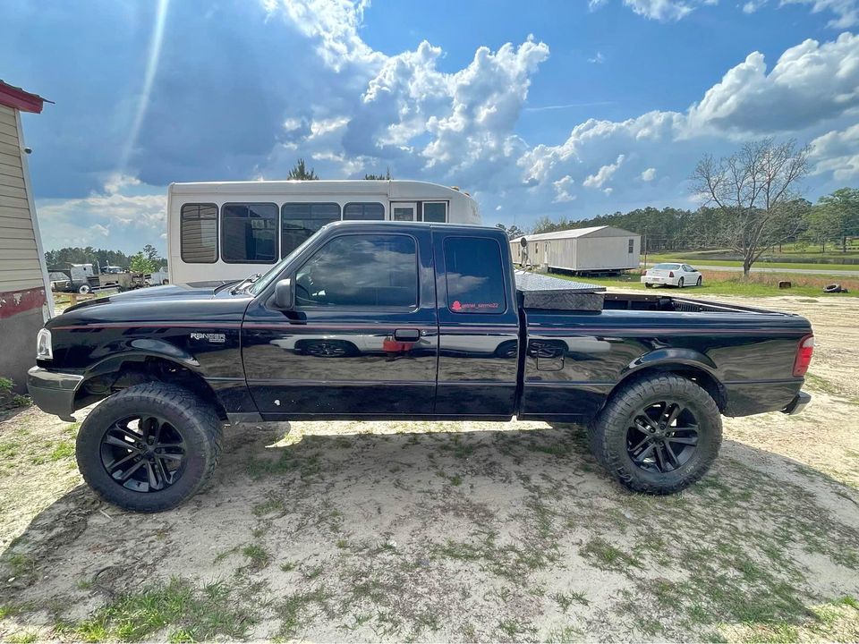

Looking around Facebook today I spotted some "Ranger wheels" for sale. Unuh first glance, those ain't Ranger wheels. No real description but I had a sneeking suspision that they are Explorer wheels. Find a couple more postings of same wheels by same seller. Read description and it says "33x12.5 18". Those definitely ain't Ranger wheels, but they kind of look good on there.
Later Explorer wheels on Ranger
Actually came across the listing with the black wheels first and it's the oldest of the three, I think it's plastidip black because the second listing (not pictured) has the wheels off the truck and you can still see remnants of the black coating on them. Now I don't plan to buy this set, for starters I'm not ready for them yet. I also think the price is way too high, I don't want 33s, and the tires are too worn to sell them and offset the cost of the right size.
Further googling confirms that they are 18x8 off a ~2017 Ford Explorer. That's a go for having the right lug pattern at least. I always thought that those Explorers had more offset than the Rangers and fit more like a car wheel. I'm figuring that the guy must have run spacers, but I can't get him to answer a simple question, he just wants to sell them.
Any of you tried to run these on a Ranger? Did you need spacer and and, if so, how thick?
