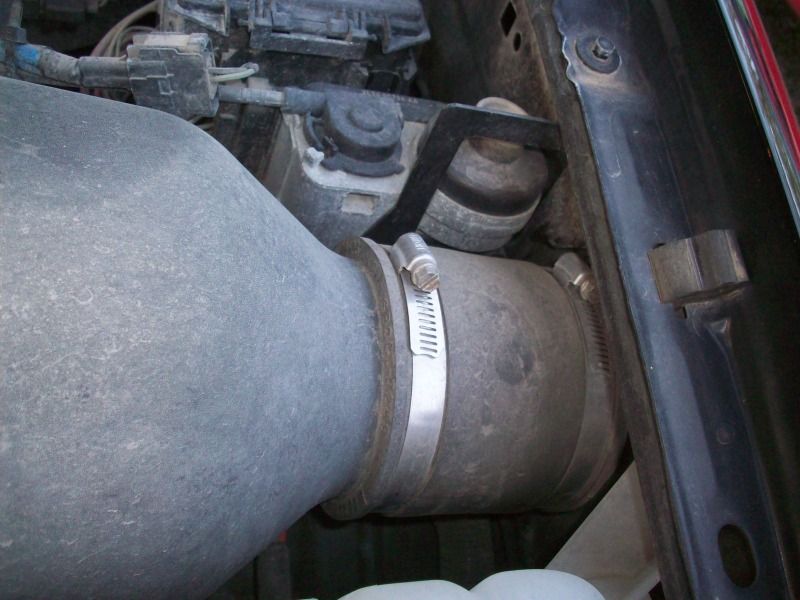

I was doing some reading on these things (in a quest for better mpg's) and came across a very interesting mod. The factory intake has a snorkel thing on it with a diameter of maybe 2 inches. The mod is to remove that restriction and add a 3 inch piece on there. So, I used a 3 inch rubber coupling, and a piece of 3 inch PVC pipe, about 3.5 inches long.

Comparison with the new piece, you can see the extreme difference in size
I had to use about 1 inch of the factory snorkel to get a secure clamp, I failed to take a photo of it. But basically, I cut an inch off and it's under the clamp on the coupling.
I also had to taper the end of the PVC to fit it into the hole in the fender well
Showing the fit into the fender well
Project complete

I will add that this works better with the the bigger air filter housing, I dont remember if it is the later ones or the 5.4 ones though. :annoyed:
I will post a pic later, on my '02 5.4 the inlet side of the air filter housing was really close to the same size as the 3" pipe.

Thanks for posting those pics, is that your truck or your Brothers? I guess I need to look for a later housing then. I don't feel much difference down low, but up top it feels like it's breathing a lot better. I might actually get worse gas mileage this go around because I keep dropping the hammer to feel it. :D
That is mine, my brother just went with an aftermarket CAI. He left the fenderside of his stock air filter housing as a heat shield, intake temps run similar to mine (5-10 degres above ambiant)
