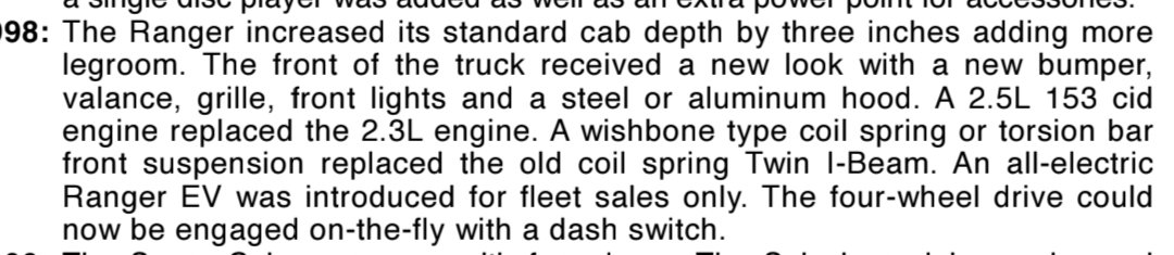

Don't the 98+ cabs have a bit more leg room to them.. somehow? Im pretty sure I remember fitting much better in my 98 and 2010 than I do in my 96..
figuring out where that room came from (if I'm not just dreaming) would probably answer the question of whether or not the newer pans could be made to work in the older truck.
I'm sure there was 3" tacked on the cab in 93. Might have been a different year...
Oooh.. probably what I'm thinking of.
I still swear I fit better in the post-beam trucks though.. I am CRAMPED in the 96.. mabey it's the seats or something.

I'm not sure about the added room but, in my friends 2011 I had less leg room (always felt like my knees were in tension) than I do in my current 96. Could be because of the aftermarket seats. I can't have the seat in the rear most position because it makes it feel like I'm stretching a bit to push the clutch in all the way. Btw I'm 6ft even if that helps for reference. I'm also a fairly large build as well so I'm not small by any means. Mine is also the super cab so that could help too
Oh yeah.. supercab helps a ton I'm sure. All my rangers apart from my old '21 have been regular cabs.
Yeah, super cabs have more room and the seats go a little farther back than a regular cab. Pretty sure it was the 93+regular cabs that got an extra 3”. I’m really not convinced that the floor pans changed other than that
They should have made that 6" instead of 3. Ford must have a lot of short engineers.

What I found in the LMC parts catalogue concerning what the two of you were talking about.
