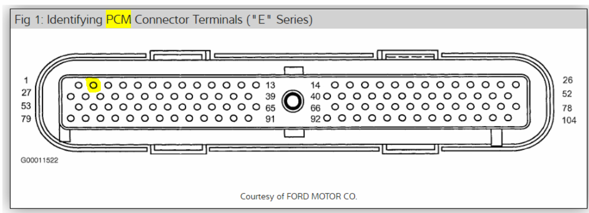

While working with the truck, I noticed the CEL did not come on when I turned on the key. It used to work. I'd replaced all the bulbs in the gauge cluster with LEDs, and it worked afterward. I back probed a test light to the actuator wire (pin #2 - pink w/ light green) on the PCM connector with the other end on the positive battery connector. The PCM was lighting up the test light as it would the CEL, if the CEL were working.

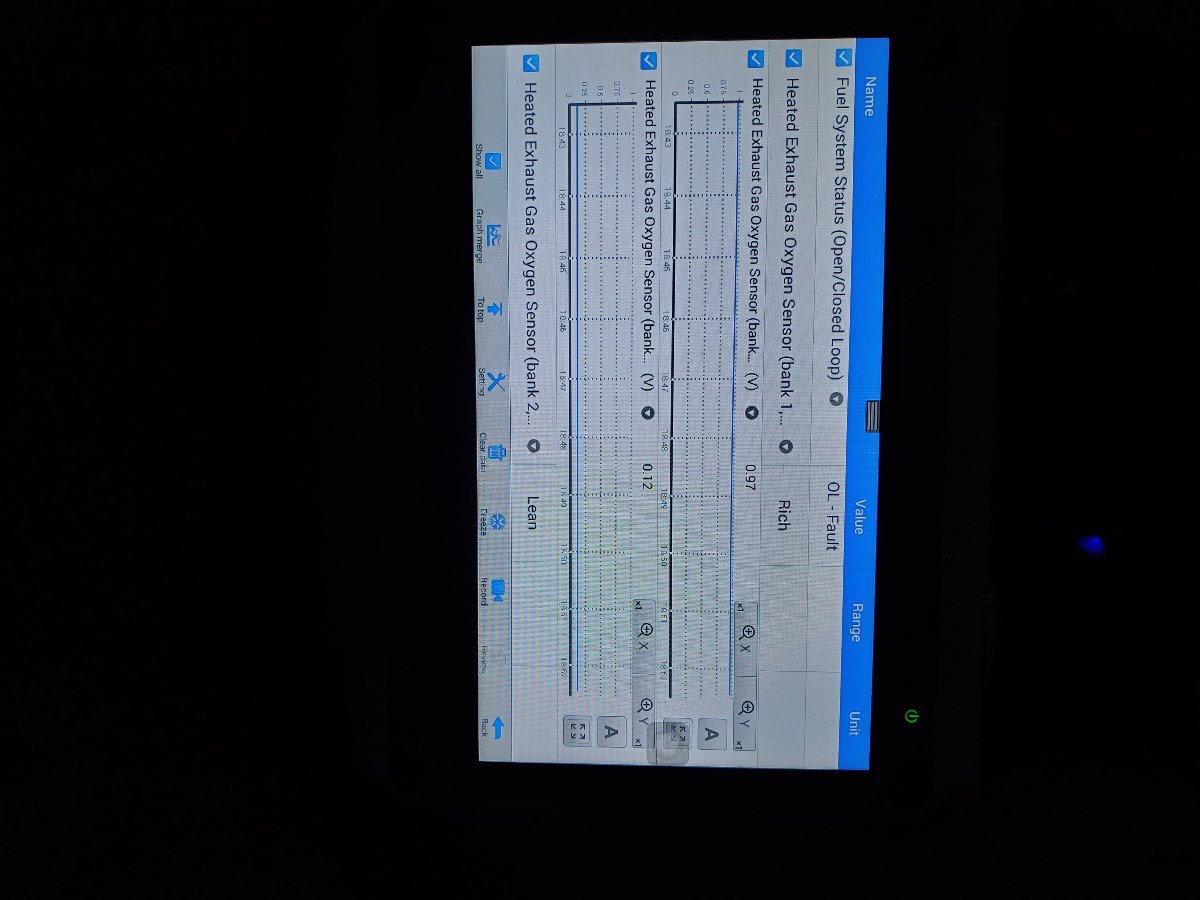

I connected the Autel scanner and watched the sensors while the engine idled. I noticed the upstream O2 sensor was pegged out at close to or at 1 V (see attached pic).
I'd replaced the upstream and downstream O2's with Denso units back on 10-24-2024. It appears the upstream has died. Is there a recommended upstream O2 sensor for the 2.3L? Preferably one that will last more than a year.

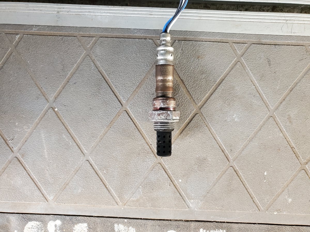

Thank you, franklin2 for the advice. I tried disconnecting both O2's. It didn't help. Now the truck will not idle. I have to keep playing with the gas pedal to keep it running. After a bit of reading, I surmised the upstream O2 may be carbon fouled and not able to read oxygen content. Thus the constant high voltage reading. I purchased a new NTK O2 sensor from Rockauto and replaced the upstream. I'm uploading a picture of the old one. It was very carbon fouled. The NTK O2 was reporting voltage normally.
