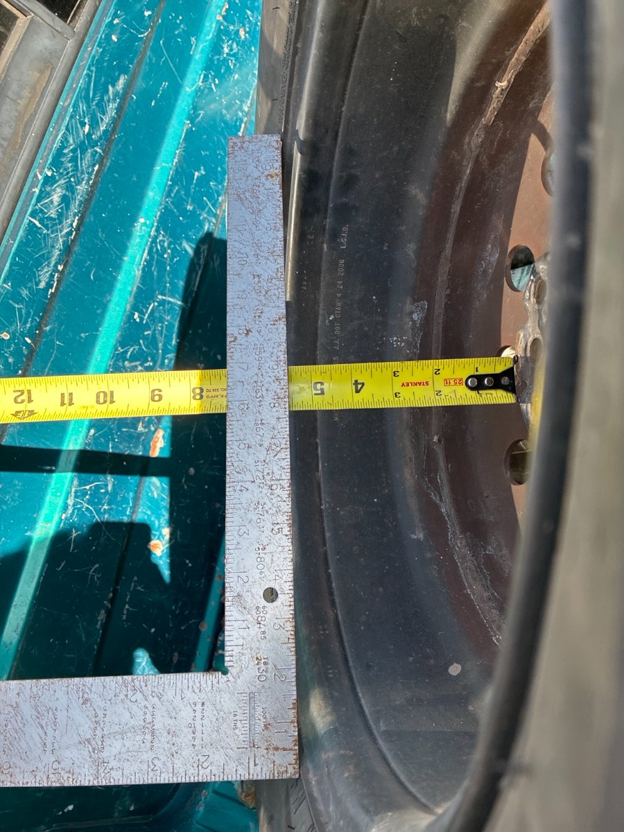

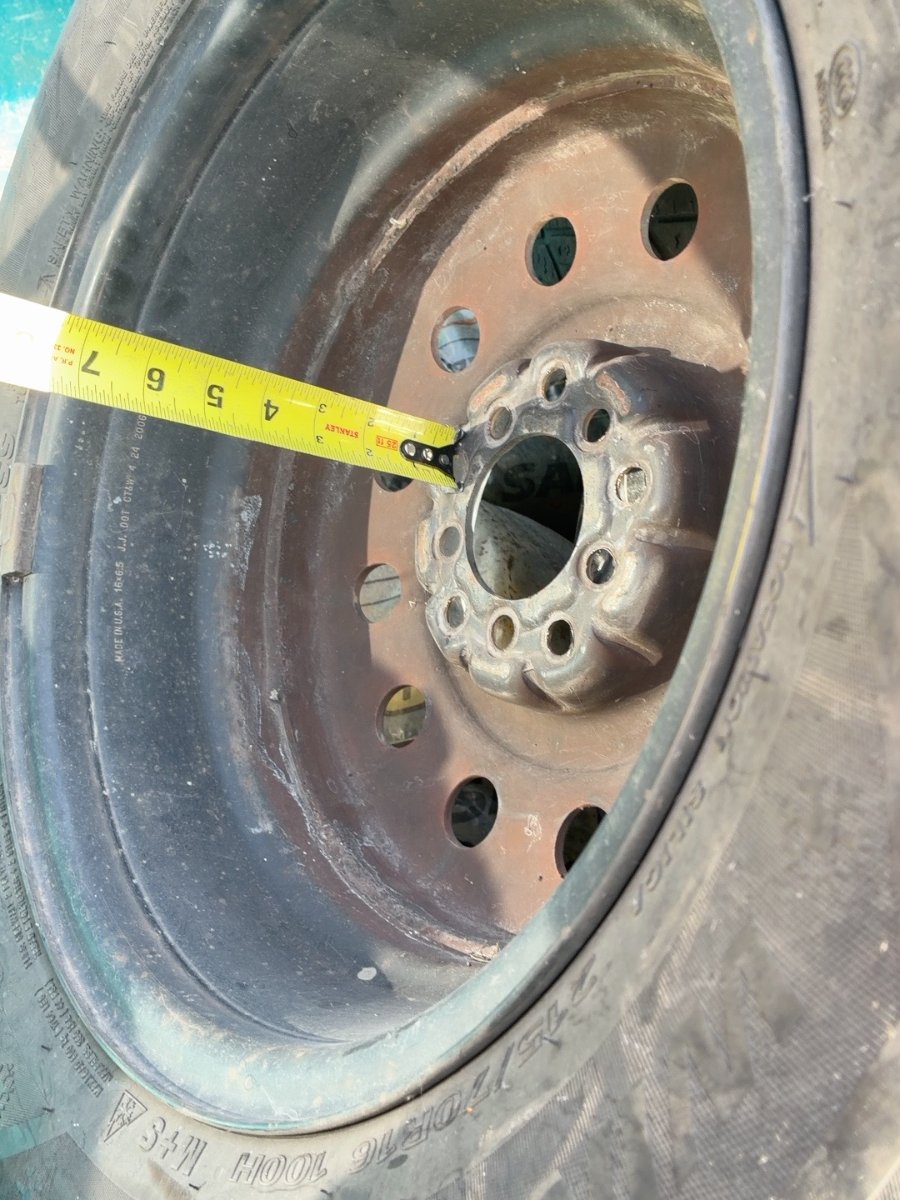

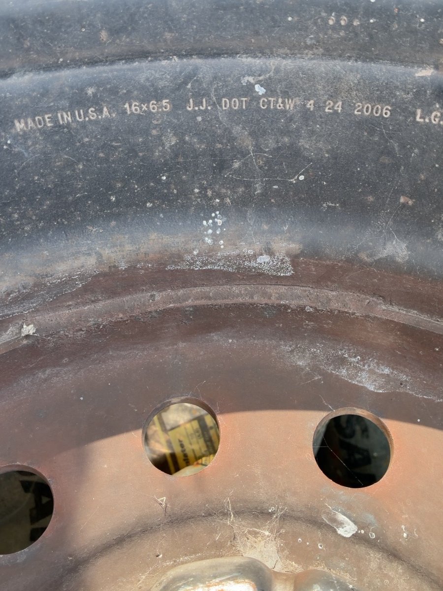

Just picked up some 16x6.5 steelies to put some winters on. I measured offset which looks like 5.5" so I think that's quite a bit further in from OEM.
OEM: 14×6, about +12 mm or ~4.0" backspacing
Steelies: 16×6.5, about +44 mm or ~5.5" backspacing
Anyone run something like these before and already figure out max tire size? I'm looking at 205/65R16 or 215/60R16.
Thanks!

Run some 1" spacers.
32mm difference between those and stock, that needs 1.25" spacers.

Those sound a little short, especially for winter tires. I'd run more like a 215/70-16. Some later model crossovers and small SUV's run that size so you should be able to find something.
I found a set of OEM Ford wheels 15" that have a better backspacing (about 4.5"). Now looking for the right tire size for studless winters.
