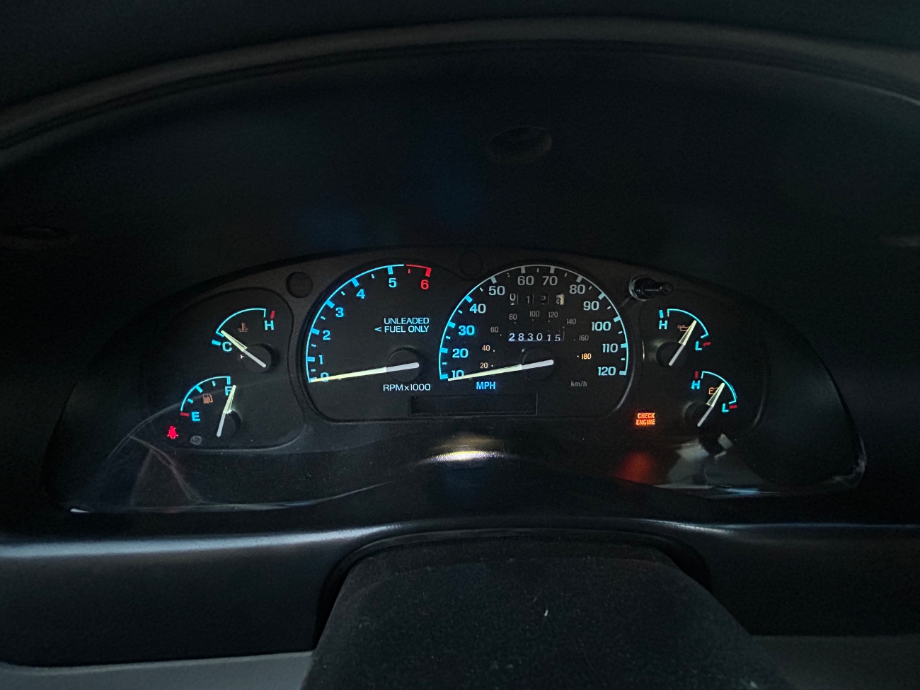

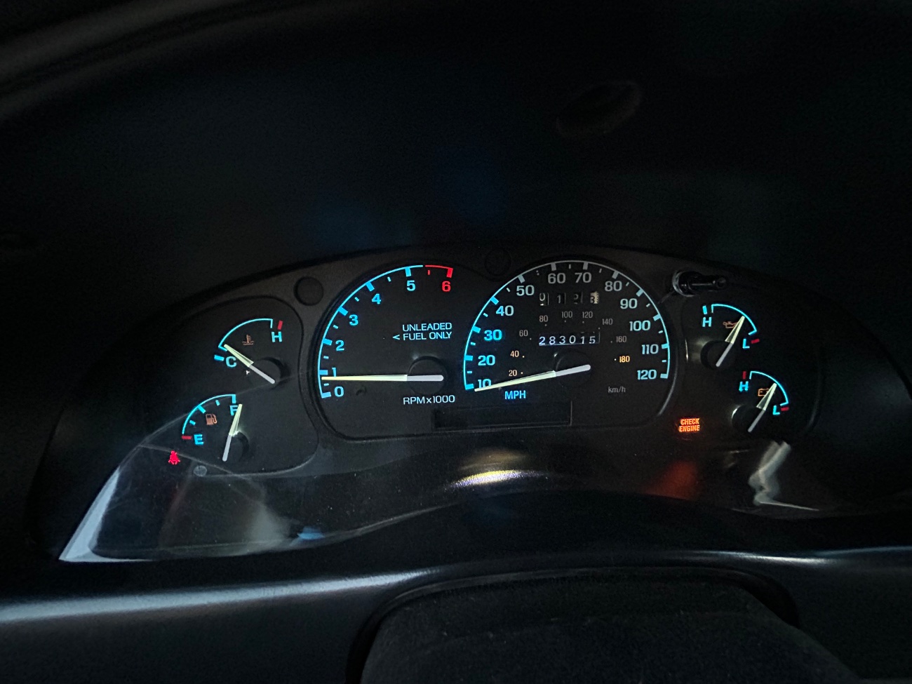

So I found the now mine 95 Ranger xl ext cab 4x4 5 speed truck in a garage that had been there 10 years. I got it running and found the coolant gauge is kinda sticky and if slap the dash it will kind of work, and the tach will drop to 0 at idle but will pick up and read when giving some throttle. I went online and got a replacement cluster that said would fit a 95 ranger. Out of the box it looked exactly the same, however when installed found that some of the warning lights are in the wrong location and the backlight is green. The one that came out of it has a blue backlight. Is there a different cluster like maybe an early cluster that was dropped and possibly hard to find? Should I send my cluster to be rebuilt especially since the bulb around the 50 mph will not light up even after changing the bulb and the socket even installing in every way and direction possible. Thanks in advance for any advice.

I have seen it self heal after driving, did a small repair to the air bag diag module due to component having a dead short but was still flashing code for the clock spring. As of Monday the airbag light went off after its check. It has codes for purge valve and the distributor gear, I’m hoping the tach issue is caused by that. I had removed all the gauges and cleaned the contact pins when I upgraded to led lights and changed worm gear for odometer, other than that I have not done anything further.

Is the picture the original or "new" cluster?
The '95 cluster is unique by year, but some sellers group '95-97 as a generation, or even '95-'02 or whenever the next major cluster overhaul was.
"<Unleaded Fuel Only" above the tach is a '95 thing, and by '98 "RPMx1000" had moved up to that position. Quick image search looks like maybe the early text format persisted through '96? Not sure what other variations might exist besides tach/no tach, explorer/mazda.

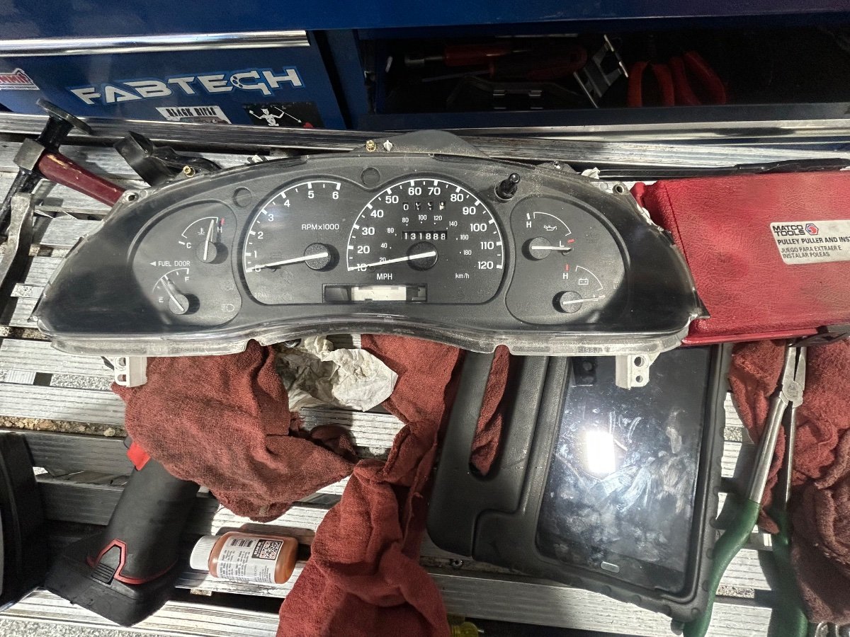

The picture is of the original cluster to the truck it has a green circuit board. The replacement that I have that was said to work looks identical but has a brown circuit board, green backlighting and until just now realized that it does not have the unleaded fuel only above the tach needle. Looks exactly the same otherwise with the exception of warning lights not in the same place. Pictured is one of my replacements. It was purchased off eBay stating it fit 95+. Maybe I should have paid more attention to what mine really looked like.

Yeah, so that's the difference. The "new" cluster isn't a '95 specifically, based on missing the "Unleaded" text. Check the part number on one of the component pieces like the printed circuit board, and it will probably start with something higher than F5.
I can't remember from last time this came up if they're plug-and-play but with noticeable differences, or if you really want to repin your connectors. I have the '95 EVTM, if somebody else has '96 or '97 we can check for sure.

I want to say I have seen a post somewhere about moving pins in the connector around to make the newer cluster work. I found a lower mileage cluster that looks exactly like the one I have with the red 6k rpm and the unleaded fuel only including the green print board. I may try it.
