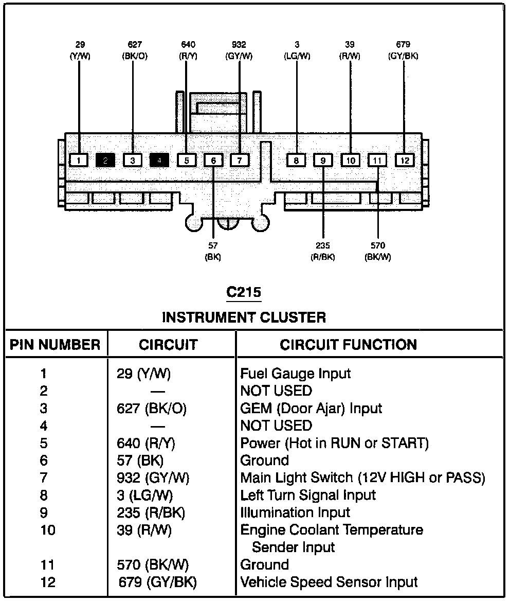

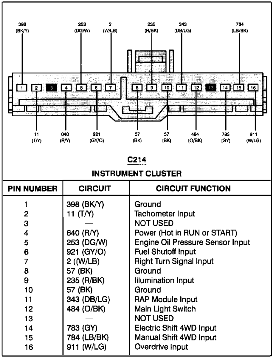

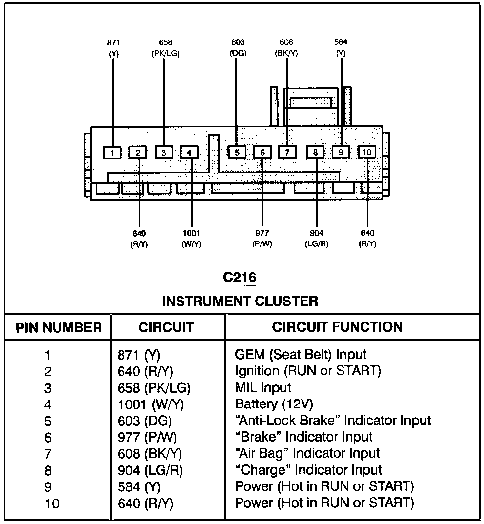

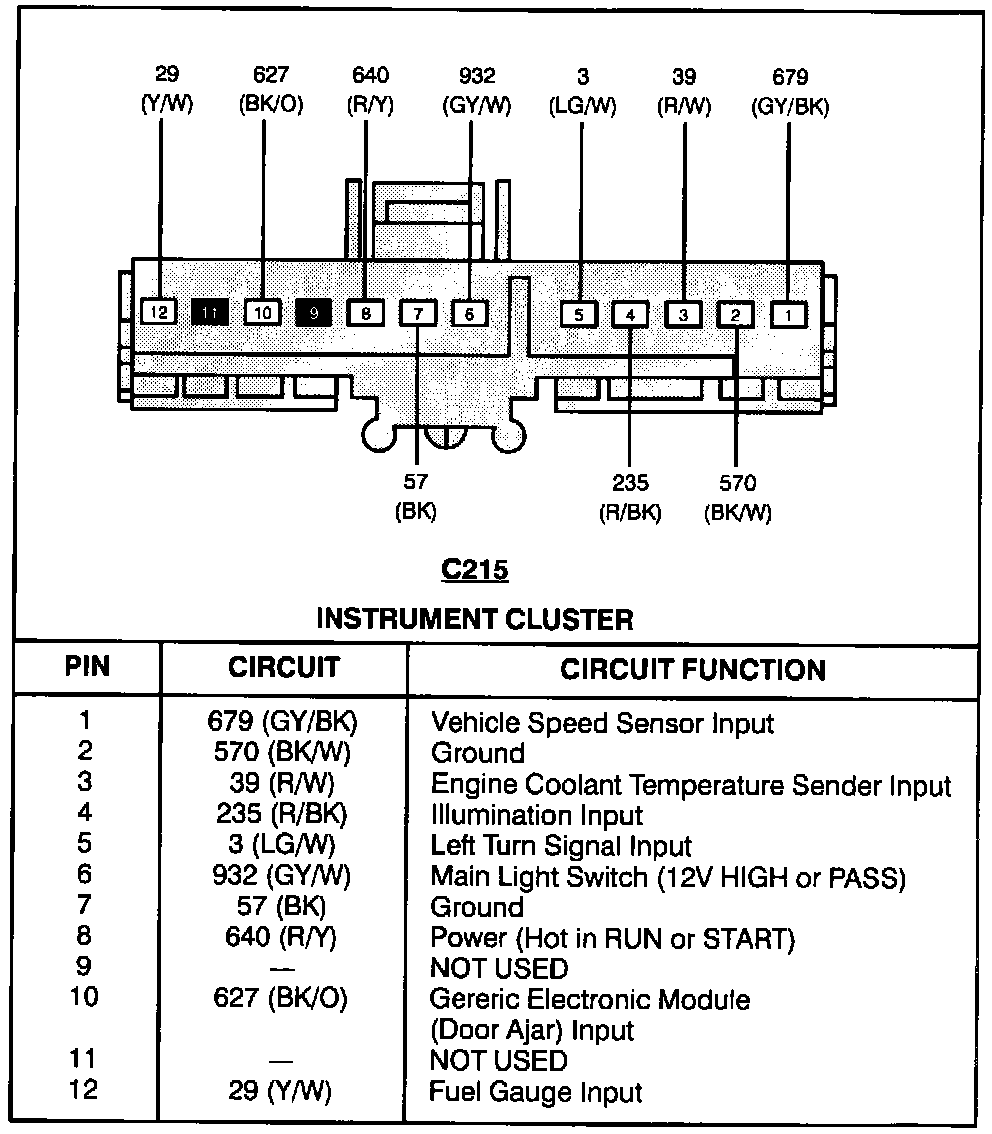

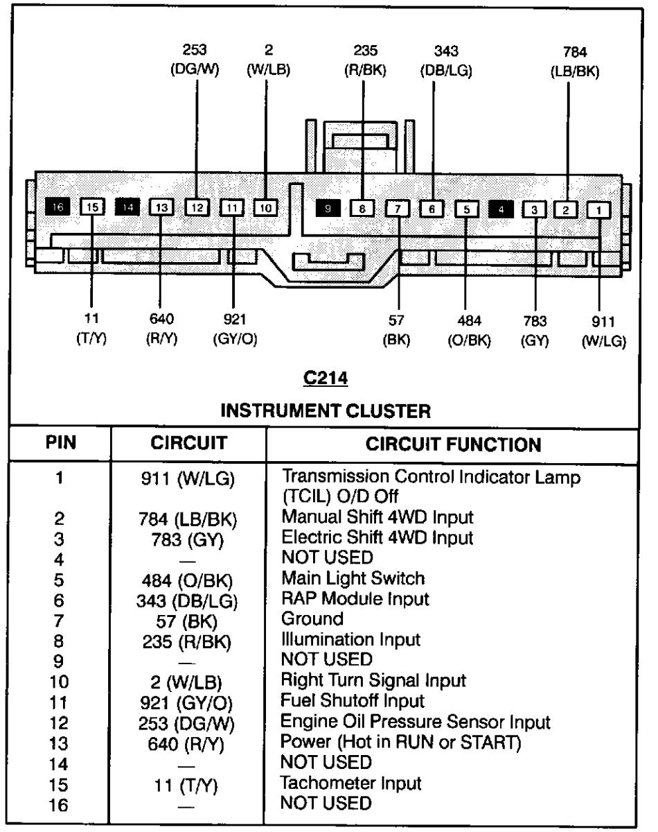

Connectors 214,215,216. 1995 listed first on each connector, 1996 listed 2nd on each connector. Lots of pin changes. And yes, 1995 was blue.

I did a cluster replacement in my 96. I put an explorer cluster in. I was told explorers have blue back lighting. Which my replacement had, i like it much better than the green. Only downside is the temp gauge is off and the door ajar stays lit. But i pulled that bulb out.
I love the blue backlighting and wouldn’t mess with the cluster except that the light at the 50 mph section does not work and the tach works when it feels like it. I’ve replace the bulb and the socket with no success. Grabbed another cluster from another 95 and everything works except the odometer and speedometer. Going to try and move the Speedo and tach from old to the new and hope the tach has a connection issue and goes away when placed in the new one
Weird. Explorer obviously has more door ajar switches, but they just go to the GEM, which only has one line to the cluster.
'97 Ranger says pin 10 of C215. Searching the net for Explorer says maybe pin 11 of C286. So if those are the same connector numbered differently, maybe it's just one pin over.
