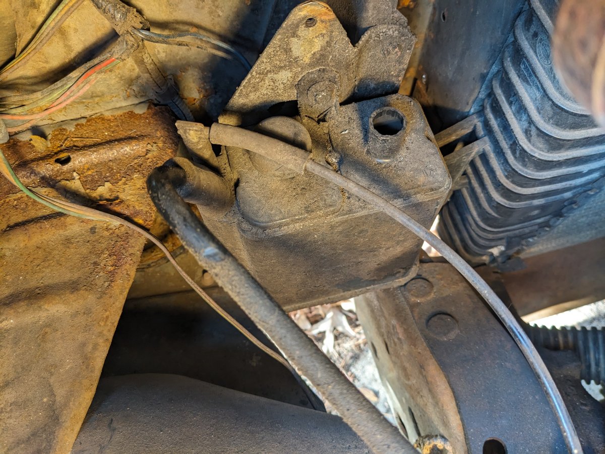

Would this be an issue with the Charcoal Canister?
Rough Idle and Stalling Out: I removed the hose from the Throttle Body and placed my thumb over the hose, and the rough idle and stalling out stopped. The motor ran like it was supposed to.
I replaced the hose and connected the new hose to the Canister line, and still the same issue.
Would this be a bad Charcoal Canister that is causing this issue?
The only hose connected to the charcoal canister is the one leading to the throttle body; the one leading to the fuel tank was cut, and the end burned.

Heres is my Canister

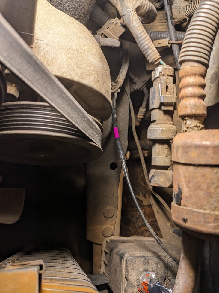

In the picture below. Purple in the splice for the line.
The line going to the gas tank had caught the power steering pump many years ago and cut the line. I just noticed it this evening when I went back out looking for the "canister purge solenoid."
I had to splice together the line going to the gas tank, and the truck stayed running on its own for the first time in five years.

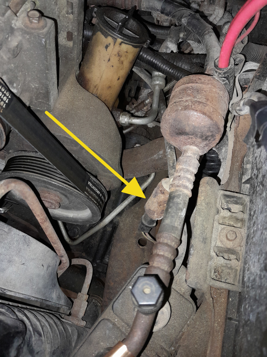

That solenoid is connected to a line that runs from the throttle body to the charcoal canister.
That patched line that runs back to the gas tank goes to a valve on top of the gas tank that has no electrical connection, it’s just a spring loaded valve.
