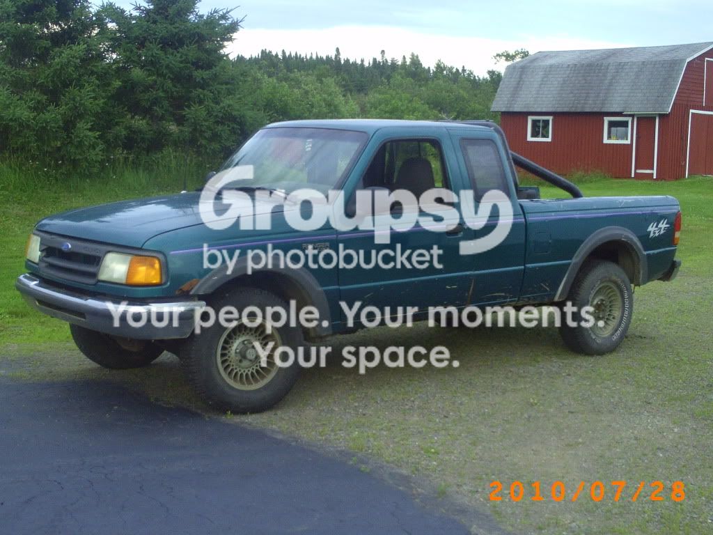

my 94 ext cab 4x4 ranger, rust free besides front fender, all floors and rockers are good and solid
3.0 engine
auto trans
electric tcase/hubs
d35 and 7.5 with 10" brakes
when i got her i put in a set of roll bars i had kicking around
wheres that damn trail..
here it is
then flexed her a bit
scrapped the carpet and bedlined it(no pics of bedliner yet)
body lift
painted the flares
put in the roll bars again
probably later this week ill be putting on manual hubs and a custom bumper i have here that was made for a jeep
