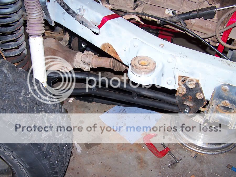

I'm going to echo what NMB2 is saying. Mount the radius arm brackets directly to the frame, those washers will create issues.
I'm going to use mounts very similar to these (this lift is going to be moved over to our Explorer...), to mount my long arm radius arm setup. Except, they have to go where the trans crossmember mounts are. I'm going to modify an old XJ crossmember for its replacement.
Keep the mounts solid to the frame.
well i have to say that it beats some of the swap's ive seen where they space the arm down with some random 3'' square tubing...
as far as solid to the frame that's out of the question now that the holes are drilled into the side of the frame, and moving them 1/4'' would mean oblonging the hole. which will be worse then spacing the whole bracket down 1/4''. so it IS what it IS
as far as "JANKEY" i dont care if my swap looks "TRICK". And I and my buddy doin the welding who is a fabricator/machinist by trade looked at the factory crossmember and couldnt see how it offered that much MORE support to the frame than what i am doin. as it only has 3 bolts that are not very well located for "support". he did however reccommend runnin some bead down the plate / OR welding on some 1/2'' tall sides to give it a little more support horizontally. He is plannin on welding a 1/4'' plate between the whole link bracket and angle when everything is said and done the washers will be gone. As i said "I used what i had to make it work". And in my first post i mentioned he will be doin all the finish welding. which I am positive will be as good if not better than anything else offered in the area. He is an Amazing welder and comes from a family of very distinguished Welders , fabrictors, pipe fitters, and/or steel workers as i have known him since grade school
And NMB2 im gonna get all jerry springer about your comment about haveing "much more experience" . YOU DONT KNOW ME, YOU DONT KNOW MY FRIENDS SO DONT JUDGE ME

it would seem like all you're trying to do is overwhelm me with all of your *friends* experience, Ill just tell you... I'm not impressed. He can be the best welder on planet earth and it still wouldnt mean jack shit because that doesnt mean he knows how to build something. Also, although that website you posted is cool, it doesnt mean shit to me.... thats not building trucks.
I dont understand what is up with so many people stuck on doing shit their own way when somebody else who knows more is trying to steer them right. You're right, its your truck and you can build it how you want, but when you come pimpin it online be ready for critisism and negative comments, especially when you're building janky shit.
the stock x-member and mount unit offers WAY more support than yours...do you understand the importance of stamped peices, and solid 1peice units.? Its not how many ****ing bolts you can jam onto a bracket, its the design.
you're right, i dont know you, and i dont know your "friends" but your display of fabrication and attitude towards redirection is a pretty good indicator.
Whats worse is that you're on the EASY part of the swap, you havent even gotten into the trac bar mounts and stuff yet.

Back to the pictures: Your giving enough, at least for me to want to see, and looking at those brackets you ordered and how nice of quality they are I 'm going to get the same ones, but mine will have to be the 3 inch wide ones, instead of the 2.63 inch ones, which are an extra 2 bucks but no biggy.
I will say great job and keep up the good work.
EVERYTHING is temporary as i will need to do alot more work to make everything I did today FINAL alot of areas do need to be adressed as you may see in the pictures. and i allready know that

I dont think anyfurther posts need to be made about the poorley constructed crossmember/link brackets when the something is final i'll let you know. I dont even have the correct bolts holdin the arms on yet (notice no Nuts on anything)
I will be pickin up all the hardware tommorow all grade 8 with norlock lock washers.
I am thinkin i will need to drill out the factory jeep upper control arm bushings to accept a 1/2'' bolt rather than the factory 11mm IIRC.
the arms should be finnally mounted to the axle for good tommorow
