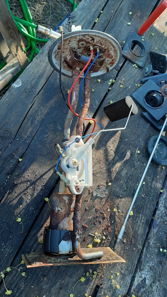

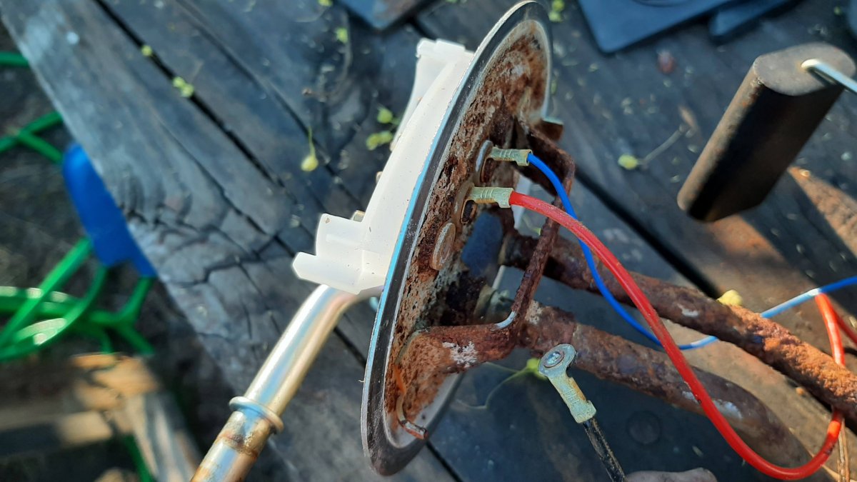

So the new eBay fuel pump is junk. The ground wire is broken off. Then I touched the blue wire and off it came. This thing is only 6 months old and looks 20.

Yes, common complaint about 3rd party fuel pumps, "keep the warranty because you will NEED IT", some go thru 3 or 4 pumps before they get one that lasts beyond 1st year
But still 4 times cheaper than a Motorcraft fuel pump
