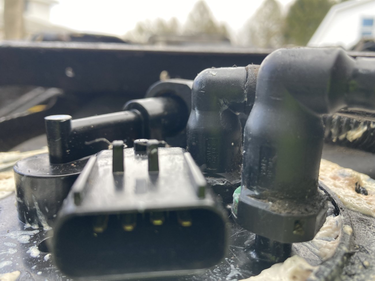

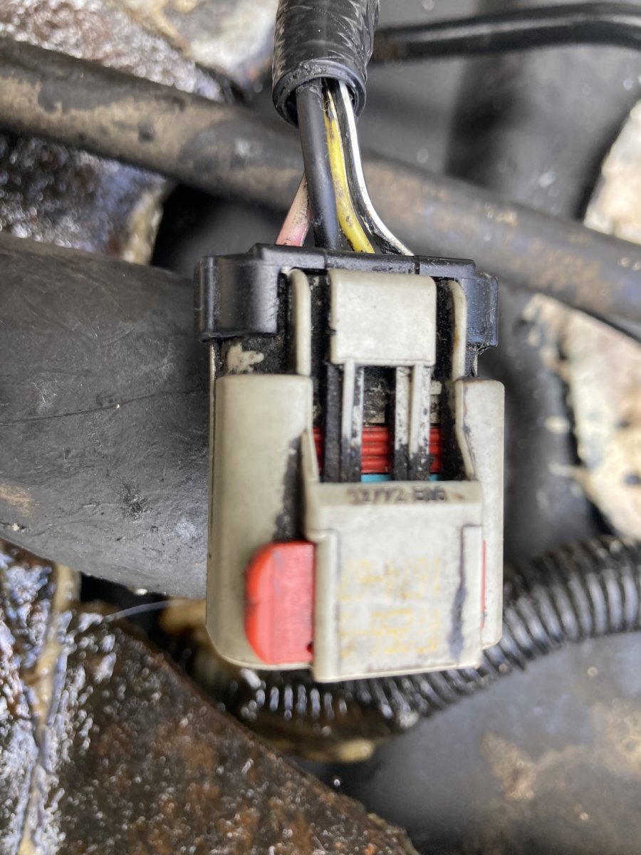

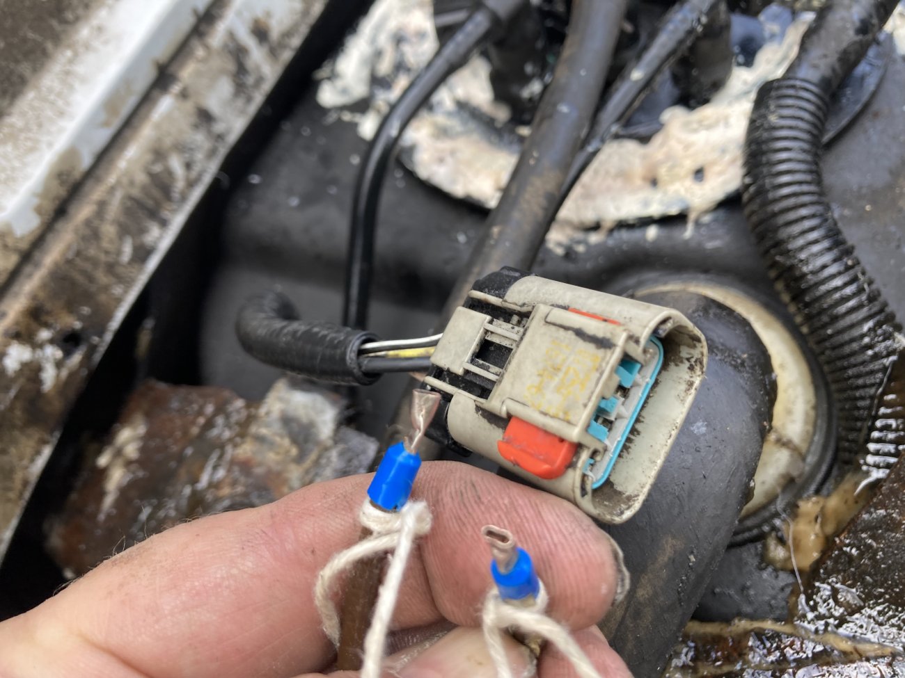

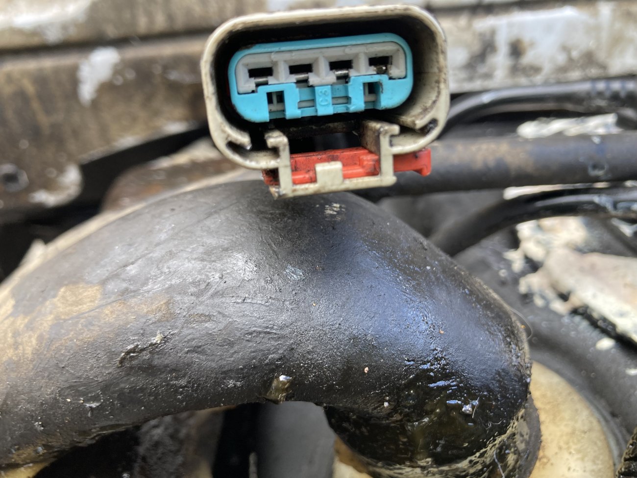

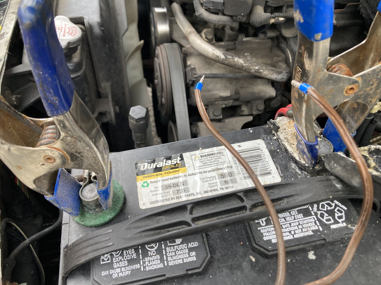

Holy shit, I think I got it! I’m 99.8% sure, it’s the connector itself. I hotwired the fuel pump to the battery and it runs. Somehow the connector makes no electrical connection to the fuel pump. I am online now searching for connectors or the little tin female connectors inside the plastic plug. Wow, that was a mental workout and a rigmarole!

I hope you have not bought anything yet.
You might be able to use what you already have.
Do you know how to take your plug apart?
If you do, you might be able to take it apart clean everything very well and tighten each of the wire ends so they are tight on the pins they plug to and reassemble everything.

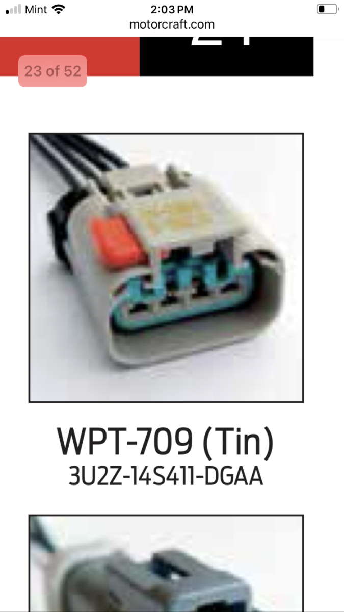

Thanks no I haven’t bought anything yet. I was gonna attempt to disassemble the plug. I posted the message wondering if anybody could point me towards a YouTube video on how to disassemble the plug. I see they sell a special tool for this purpose. I’m wondering if I could get away with a really large sewing needle.

I found a lot of really nice videos on YouTube about “unpinning a connector”.
Do you have any pics as they're called Harbor Freight sells a set of four for around $3.
