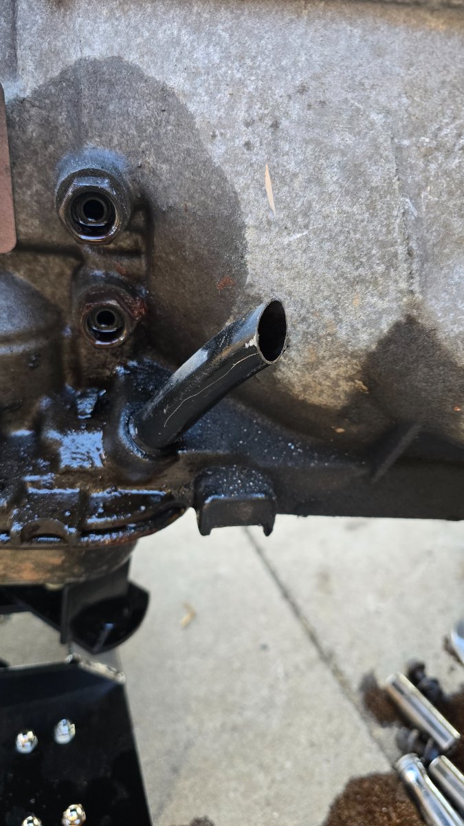

Today's progress. That's a heck of a job for one old man. Couldn't get the bolt out of the head that holds the dipstick tube. So I cut the tube. No big deal, except that I forgot to pull the dipstick out first. Oops. Lots of oil leaking from rear of transmission.

I wasn't sure how easy the tube would pull out of the transmission.
Fair, if I remember right I found out by accident...
should just pop out.
That's what I assumed. But, to make it pop out properly, I would have the drop the transmission vertically. But I knew it had to move back horizontally before going down. Just wasn't sure how all that would work out. In hindsight, the results couldn't have been much worse than what I did.

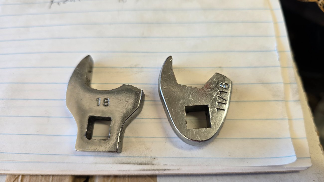

Dang it! What a day. The goal was to get the engine out. First fight was getting the fan clutch off the water pump shaft. Slightly challenging. But I won. Fan, radiator and AC condenser are out. Then I went through looking to see what else needed to be disconnected. The wind blew the hood shut. But it somehow jammed the first latch - the one you release with the lever in the grill. I fought that and finally took the sawzall to the grill and unbolted the latch. Next, I removed the upper intake. I know I'll need that out of the waybto loft the engine. Finally, I started unbolting engine mounts. Passenger side is easy access. I remived the bolts going through the mount into the block. Driver side? Can't do those bolts unless I remove the front differential. So I tried the big nuts on top that hold the top part of the mount to the rubber, or something. Still not easy. I got one. But the other is so close to tje block thst it's nearly impossible to get a breaker bar on the socket. Broke 2 crows feet. Finally got it broke loose. But it's loc-tited on. So every 1/6th of a turn is a fight. Finally quit for the day. As far as I know, that one nut and gravity are the only things holding the engine in there. When I get back at it next, I might just unbolt the diff and let it drop out of the way.

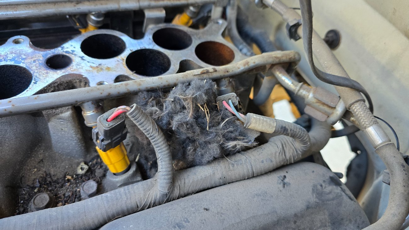

Todays carnage.
Someone was living here. I don't see any wiring damage nearby.
