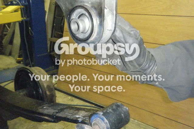

In went the Front D44 '79 Ford axle
-high pinion
-shortened
-HD universal joints
-4.56 gears
-Detroit Full Locker.
-custom radius arms
-Disc brakes
-6''James duff coils
-custom chromoly axle shafts from currie.com

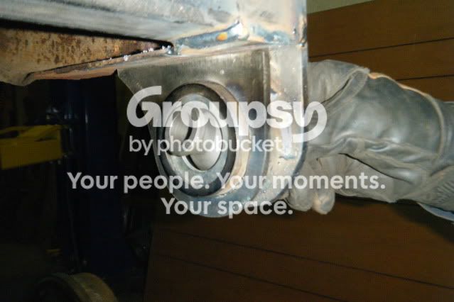

In with the new
Rear Ford 8.8 axle
-4.56 gears
-drum brakes
-Dutchman axles hardened -custom size
Exploder leaf packs

Looking pretty good so far! What wheelbase are you shooting for? Any pics of the front leaf mounts and how close they are to the body mounts?

the wheelbase is 114" and the front leaf mount is from a explorer as the leafs are inboard (under the frame)
