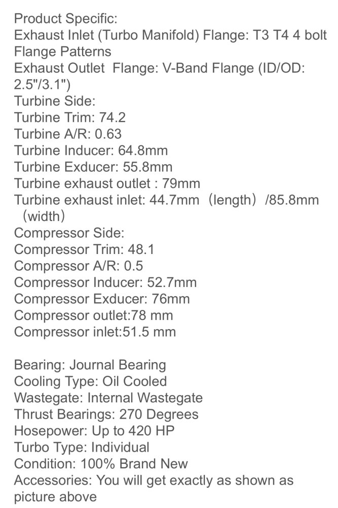

How is your exhaust setup looking? What size turbo?
Exhaust I cut from just behind where the Y ends past the first cross member it’s 2->2.5 as that’s the same as the out on the turbo. Here’s the turbos info in a pic I thinking of getting one with a .57 a/r exhaust housing to see if that’ll spool.
